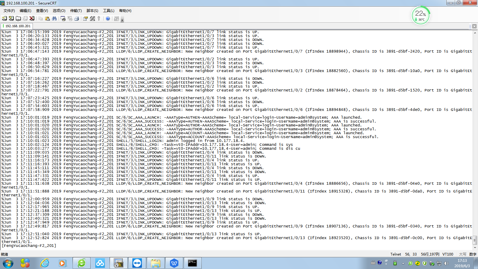

POE交换机连接无线接口一直UP down
2019-06-03提问
  • 1收藏,4246浏览
AP也是H3C的
# interface GigabitEthernet1/0/7
 port link-type trunk
 undo port trunk permit vlan 1
 port trunk permit vlan 860 to 861 863
 port trunk pvid vlan 860
 poe enable
