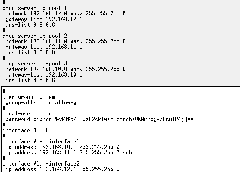

S7006三层交换机只写两个VLAN不能互通,写完地址池也不行 该怎么解决
粉丝:24人 关注:3人
比如7006上现在有vlan10和vlan20,
如果vlan10虚接口和vlan20虚接口都配置了ip地址,并且都是下面电脑的网关地址,那么vlan10里面的电脑A获取到一个假设192.168.10.100这个ip地址网关192.168.10.1(即7006的vlan10虚接口ip地址),那么此时电脑A是可以通过自己的网关192.168.10.1 找到 vlan20的192.168.20.1转发一下,最终可以与vlan20里面的电脑B假设192.168.20.10通信(即可以相互ping通)。

问题是PING不通 两个VLAN之间不通 需要什么命令才可以互通吗?
zhiliao_EJ25d 发表时间:2019-06-19
回复zhiliao_EJ25d:
粘一下配置
oasis2049 发表时间:2019-06-19
[H3C]dis cur # version 5.20, Release 7708P09 # sysname H3C # domain default enable system # telnet server enable # switch-mode standard switch-mode normal slot 2 switch-mode normal slot 3 # switch-mode route-normal # password-recovery enable # vlan 1 # vlan 2 # domain system access-limit disable state active idle-cut disable self-service-url disable # dhcp server ip-pool 1 network 192.168.12.0 mask 255.255.255.0 gateway-list 192.168.12.1 dns-list 8.8.8.8 # dhcp server ip-pool 2 network 192.168.11.0 mask 255.255.255.0 gateway-list 192.168.11.1 dns-list 8.8.8.8 # dhcp server ip-pool 3 network 192.168.10.0 mask 255.255.255.0 gateway-list 192.168.10.1 dns-list 8.8.8.8 # user-group system group-attribute allow-guest # local-user admin password cipher $c$3$cZIFvzE2cklw+tLeMndh+UKMrrogxZDsuIR4jQ== # interface NULL0 # interface Vlan-interface1 ip address 192.168.10.1 255.255.255.0 ip address 192.168.11.1 255.255.255.0 sub # interface Vlan-interface2 ip address 192.168.12.1 255.255.255.0 # interface GigabitEthernet2/0/1 port link-mode bridge port link-type trunk port trunk permit vlan all

vlan2下面有接口么,看下现在vlan1 和 vlan2 是不是都up的,dis ip int br查看
回复oasis2049:
是UP了 该怎么解决呢
