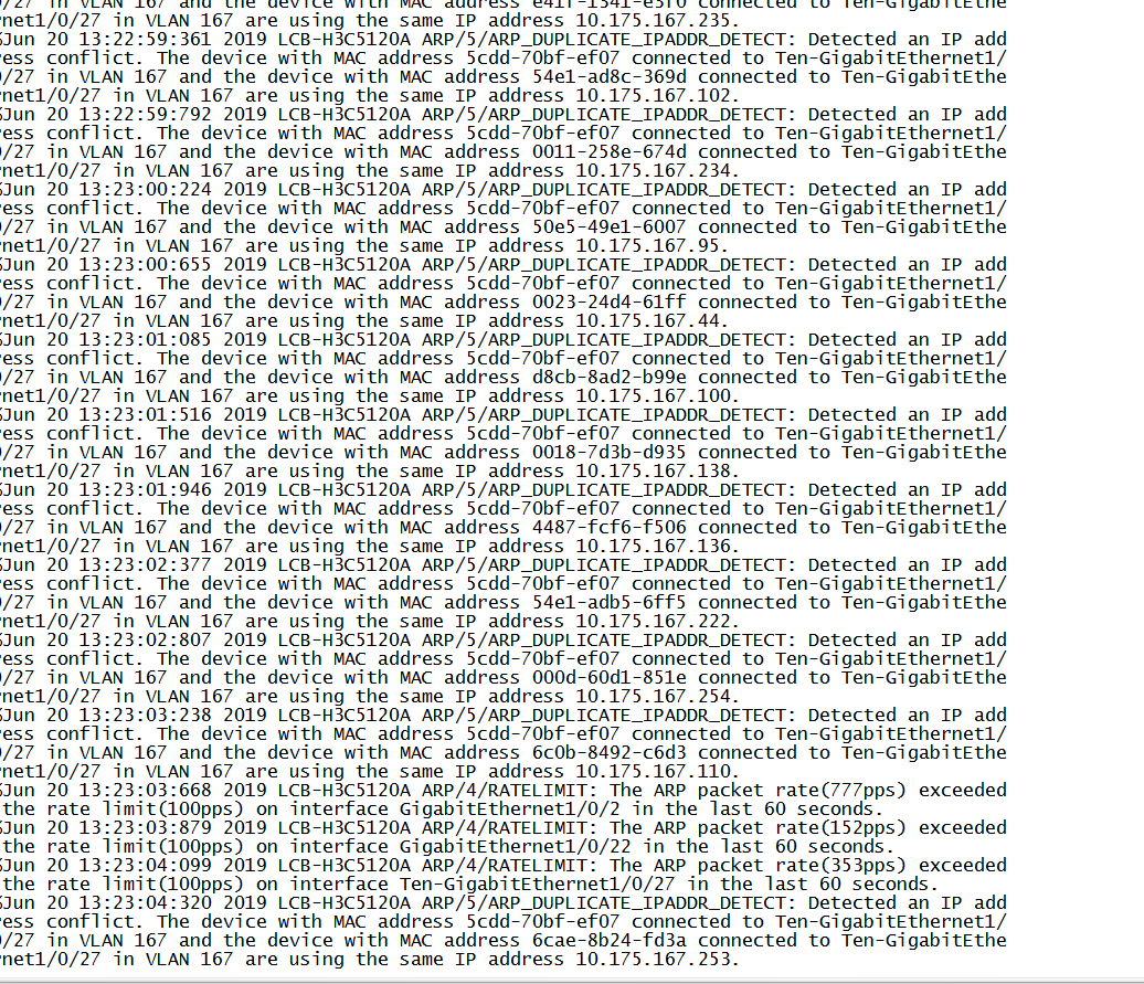

交换机一直提示MAC报错
2019-06-20提问
  • 1收藏,4262浏览
%Jun 20 13:23:04:320 2019 LCB-H3C5120A ARP/5/ARP_DUPLICATE_IPADDR_DETECT: Detected an IP address conflict. The device with MAC address 5cdd-70bf-ef07 connected to Ten-GigabitEthernet1/0/27 in VLAN 167 and the device with MAC address 6cae-8b24-fd3a connected to Ten-GigabitEthernet1/0/27 in VLAN 167 are using the same IP address 10.175.167.253.

多个地址冲突,冲突mac和连接的接口如报警,并从有很多arp超限速,建议排查下环路或者arp攻击

看下是不是地址冲突了
