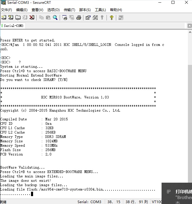

MSR810可以console口进后台,但是不知道如何恢复成192.168.1.1后台界面设置,求各位大佬指点迷津

来自 192.168.1.1 的回复: 字节=32 时间<1ms TTL=255 192.168.1.1 的 Ping 统计信息: 数据包: 已发送 = 4,已接收 = 4,丢失 = 0 (0% 丢失), 老大,这应该是通的吧,但是con连接代码如下:[H3C]ip http enable ^ % Unrecognized command found at '^' position. [H3C]ip http en ^ % Unrecognized command found at '^' position.
zhiliao_vzM8w 发表时间:2019-06-27 更多>>

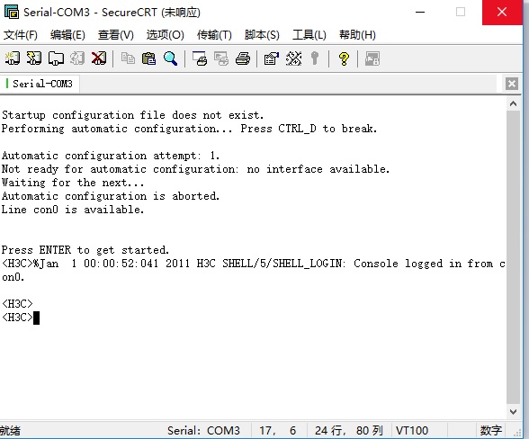

[H3C] <H3C> <H3C> <H3C>inter g0/0 ^ % Unrecognized command found at '^' position. <H3C>sys System View: return to User View with Ctrl+Z. [H3C] <H3C>ip add 192.168.1.1 ^ % Unrecognized command found at '^' position. <H3C>reset save The saved configuration file will be erased. Are you sure? [Y/N]:y Configuration file does not exist! <H3C>reset save The saved configuration file will be erased. Are you sure? [Y/N]:Y Configuration file does not exist! <H3C>reboot Start to check configuration with next startup configuration file, please wait.........DONE! Current configuration may be lost after the reboot, save current configuration? [Y/N]:N This command will reboot the device. Continue? [Y/N]:Y Now rebooting, please wait... The specified boot file does not exist. <H3C>

老大,我是小白,不知是否操作正确,不过进不了1:的IP设置啊
