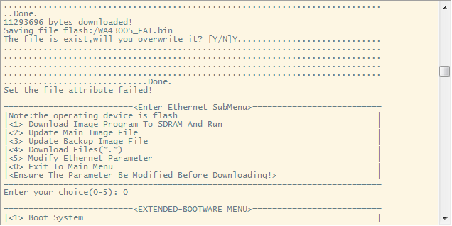

712c刷胖,请大佬看看哪不对

传完版本后重启试试
AP瘦切胖配置案例(Bootrom) 1. 使用Console口登入到命令行,从官网下载WAP621的软件版本,将压缩包解压,将里面的文件名称修改为wa2600a_fat.bin 2. 电脑网卡设置为:192.168.0.1 255.255.255.0,如下例子打开TFTP服务器,把软件版本WA2600a_fat.bin放到电脑桌面上,TFTP服务器目录指向电脑桌面,然后点击确定 3. 在AP重启的时候按住Ctrl+B进入设备的bootroom菜单,以下标黑部分为设备自动打印部分,标红加粗的命令是需要手动输入。 ===============<EXTEND-BOOTWARE MENU>========================= |<1> Boot System |<2> Enter Serial SubMenu |<3> Enter Ethernet SubMenu |<4> File Control |<5> Restore to Factory Default Configuration |<6> Skip Current System Configuration |<7> BootWare Operation Menu |<8> Clear Super Password |<9> Storage Device Operation |<0> Reboot =============================================================== Ctrl+C: Display Copyright Ctrl+F: Format File System Enter your choice(0-9): Ctrl+F y Enter your choice(0-9): 3(此处输入) ================<Enter Ethernet SubMenu>========================== |Note:the operating device is flash |<1> Download Application Program To SDRAM And Run |<2> Update Main Application File |<3> Update Backup Application File |<4> Update Secure Application File |<5> Modify Ethernet Parameter |<0> Exit To Main Menu |<Ensure The Parameter Be Modified Before Downloading!> ============================================================= 4. 进入修改以太网参数菜单,使用TFTP网络协议传输wa2600a_fat.bin到AP上 Enter your choice(0-5): 5 ===========<ETHERNET PARAMETER SET>===================== |Note: '.' = Clear field. | '-' = Go to previous field. | Ctrl+D = Quit. =============================================================== Protocol (FTP or TFTP) : TFTP //忽略输出内容,直接输入TFTP,然后回车 Load File Name :wa2600a_fat.bin //忽略输出内容,直接输入wa2600a_fat.bin,然后回车 Target File Name :wa2600a_fat.bin //忽略输出内容,直接输入wa2600a_fat.bin,然后回车 Server IP Address :192.168.0.1 //忽略输出内容,直接输入电脑主机的 IP,比如192.168.0.1,然后回车 Local IP Address :192.168.0.50 //忽略输出内容,直接输入和电脑主机的ip同一网段,比如192.168.0.50,然后回车 Gateway IP Address :0.0.0.0 //忽略输出内容,直接回车 备注:注意给电脑手动配置一个与AP同网段的IP地址,保证电脑与AP路由可达 =============<Enter Ethernet SubMenu>========================== |Note:the operating device is flash |<1> Download Application Program To SDRAM And |<2> Update Main Application File |<3> Update Backup Application File |<4> Update Secure Application File |<5> Modify Ethernet Parameter |<0> Exit To Main Menu |<Ensure The Parameter Be Modified Before Downloading!> ============================================================= Enter your choice(0-5): 2 //此时可以看到TFTP服务器上数据上传的滚动 Loading..................................................................... ....................................Done! 5. 返回主菜单,查看设备上是否真的已经上传了该软件版本 =================<Enter Ethernet SubMenu>========================== |Note:the operating device is flash |<1> Download Application Program To SDRAM And R |<2> Update Main Application File |<3> Update Backup Application Fil |<4> Update Secure Application File |<5> Modify Ethernet Parameter ||<0> Exit To Main Menu |<Ensure The Parameter Be Modified Before Downloading!> |================================================================= Enter your choice(0-5): 0 ===============<EXTEND-BOOTWARE MENU>=========================== <1> Boot System <2> Enter Serial SubMenu <3> Enter Ethernet SubMenu <4> File Control <5> Restore to Factory Default Configuration <6> Skip Current System Configuration <7> BootWare Operation Menu <8> Clear Super Password <9> Storage Device Operation <0>Reboot ========================================================== Ctrl+C: Display Copyright Ctrl+F: Format File System Enter your choice(0-9): 4 =====================<File CONTROL>=============================== |Note:the operating device is flash <1> Display All File(s) <2> Set Application File type <3> Delete File <0> Exit To Main Menu ============================================================== Enter your choice(0-3): 1 Display all file(s) in flash: 'M' = MAIN 'B' = BACKUP 'S' = SECURE 'N/A' = NOT ASSIGNED |NO. Size(B) Time Type Name ||1 9124864 Aug/08/2008 20:00:00 M wa2600a_fat.bin ============================================================== 6. 返回主菜单,将设备进行重启 |Note:the operating device is flash <1> Display All File(s) <2> Set Application File type <3> Delete File <0> Exit To Main Menu ================================================================= Enter your choice(0-3): 0 ==================<EXTEND-BOOTWARE MENU>=========================== <1> Boot System <2> Enter Serial SubMenu <3> Enter Ethernet SubMenu <4> File Control <5> Restore to Factory Default Configuration <6> Skip Current System Configuration <7> BootWare Operation Menu <8> Clear Super Password <9> Storage Device Operation <0>Reboot ================================================================== Ctrl+C: Display Copyright Ctrl+F: Format File System Enter your choice(0-9): 0 System is starting... 7. 重启设备完成后就可以使用默认的管理地址192.168.0.50登录AP进行管理了。登录AP的默认用户名是admin,密码是h3capadmin。

兄弟 没看明白

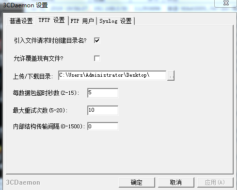

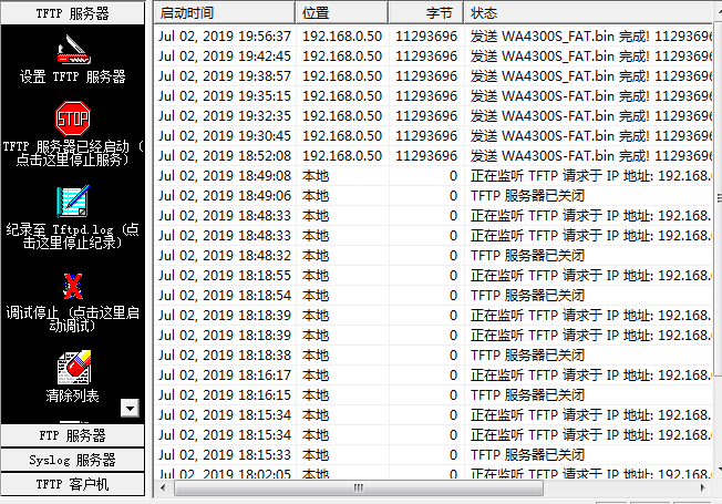

上传的文件名 小写 wa4300s_fat.bin
迪迦奥特曼 发表时间:2019-07-02 更多>>
终于看到了,设置文件属性失败是吧。
