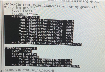

设备S6800-54QF,添加镜像端口失败,报错如下。
在另外一台设备镜像配置相同,无报错,什么原因呢?

看看接口下是否有冲突配置?
接口配置如下,无冲突吧 # interface Ten-GigabitEthernet1/0/5 port link-mode bridge description TO_BJDXH03B_EI01_SV_AS_01&02_XG1/0/49 port link-type trunk undo port trunk permit vlan 1 port trunk permit vlan 2700 to 2799 port link-aggregation group 150 #
