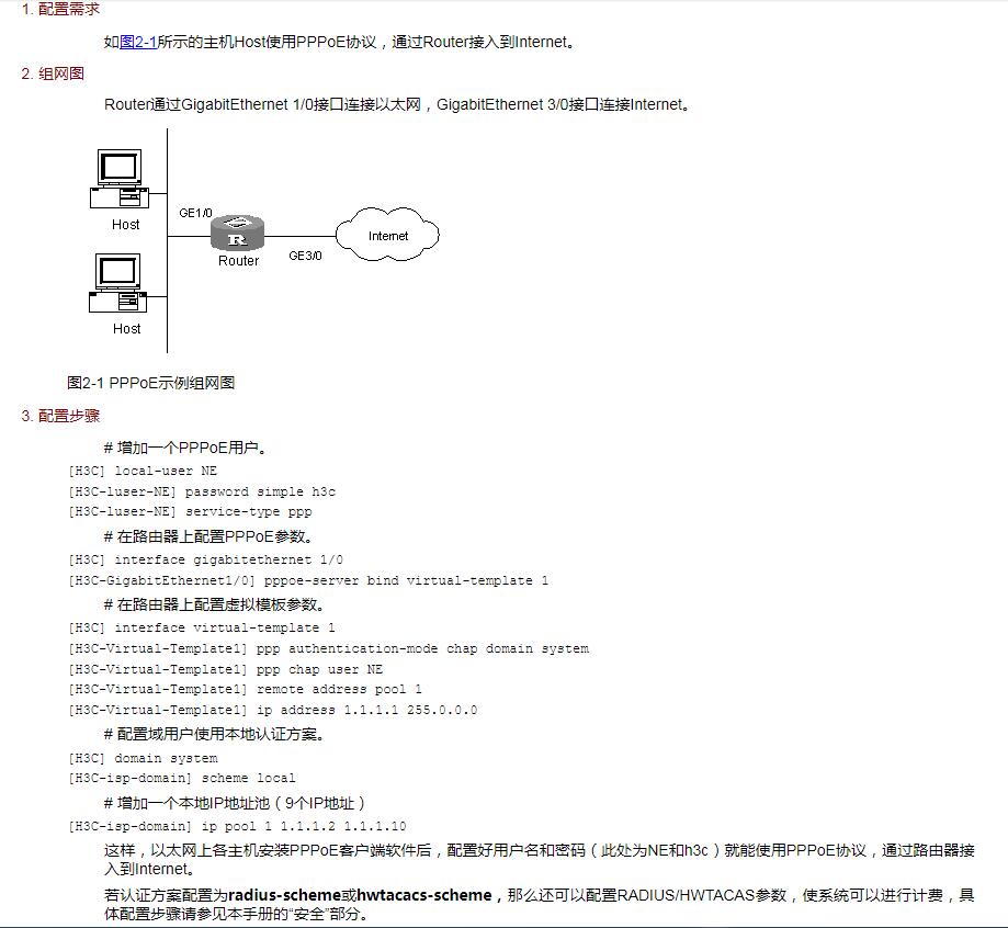

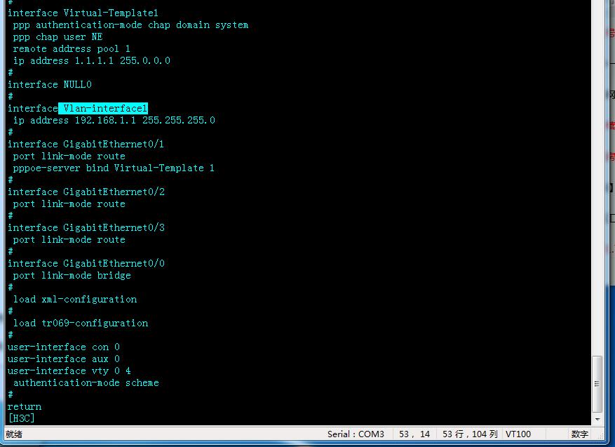

园区有台MSR5006路由器,想把路由器配置成PPPOE-Server,用拨号上网的方式管理两个用户。现按照官网的技术文档配置了多次,拨号上网都是提示错误720。最后完全按照官网技术文档复制命令,仍出现错误,不得不怀疑官方能力。
相关配置如下:

案例没有问题,我建议你百度一下这个报错,网上有很多解释,都是和终端有关。下面有两个例子

肯定是设备配置问题两台PC均出现同样提示,两台PC连接联通宽带都是一次成功,另外用路由器自动拨号也无法连接MSR5006
zhiliao_jCq8d 发表时间:2019-07-18

网上所有的评论,都是指向终端侧有配置或者其他影响。如果觉得一定是设备问题,你可以把5006配置全删了,手动配置,尤其是密码等别配错了,然后开debug看有什么提示

*Jul 15 09:22:11:133 2005 H3C PPPOE/7/debug2: 2005-7-15 9:22:11.133: PPPoE :GigabitEthernet0/1 IN discovery packet, len 60 ff ff ff ff ff ff 28 d2 44 a5 f9 40 88 63 11 09 00 00 00 14 01 01 00 00 01 03 00 0c 7f 00 00 00 00 00 00 00 f8 00 00 00 00 00 00 00 00 00 00 00 00 00 00 00 00 00 00 00 00 00 00 00 *Jul 15 09:22:11:133 2005 H3C PPPOE/7/debug2: 2005-7-15 9:22:11.133: PPPoE Event: GigabitEthernet0/1, IN PADI packet *Jul 15 09:22:11:133 2005 H3C PPPOE/7/debug2: 2005-7-15 9:22:11.133: PPPoE :GigabitEthernet0/1 OUT discovery packet, len 59 28 d2 44 a5 f9 40 38 22 d6 27 f1 24 88 63 11 07 00 00 00 27 01 01 00 00 01 03 00 0c 7f 00 00 00 00 00 00 00 f8 00 00 00 01 02 00 0f 48 33 43 33 38 32 32 64 36 32 37 66 31 32 34 *Jul 15 09:22:11:133 2005 H3C PPPOE/7/debug2: 2005-7-15 9:22:11.133: PPPoE Event: GigabitEthernet0/1, OUT PADO packet %Jul 15 09:22:11:141 2005 H3C IFNET/3/LINK_UPDOWN: Virtual-Template1:0 link status is UP. *Jul 15 09:22:11:141 2005 H3C PPPOE/7/debug2: 2005-7-15 9:22:11.133: PPPoE :GigabitEthernet0/1 IN discovery packet, len 60 38 22 d6 27 f1 24 28 d2 44 a5 f9 40 88 63 11 19 00 00 00 14 01 01 00 00 01 03 00 0c 7f 00 00 00 00 00 00 00 f9 00 00 00 00 00 00 00 00 00 00 00 00 00 00 00 00 00 00 00 00 00 00 00 *Jul 15 09:22:11:141 2005 H3C PPPOE/7/debug2: 2005-7-15 9:22:11.133: PPPoE Event: GigabitEthernet0/1, IN PADR packet *Jul 15 09:22:11:141 2005 H3C PPPOE/7/debug2: 2005-7-15 9:22:11.140: PPPoE :GigabitEthernet0/1 OUT discovery packet, len 40 28 d2 44 a5 f9 40 38 22 d6 27 f1 24 88 63 11 65 00 01 00 14 01 01 00 00 01 03 00 0c 7f 00 00 00 00 00 00 00 f9 00 00 00 *Jul 15 09:22:11:141 2005 H3C PPPOE/7/debug2: 2005-7-15 9:22:11.140: PPPoE Event: GigabitEthernet0/1, session 1(Virtual-Template1:0), OUT PADS packet *Jul 15 09:22:11:491 2005 H3C PPPOE/7/debug2: 2005-7-15 9:22:11.140: PPPoE: GigabitEthernet0/1 OUT session data for Virtual-Template1:0 (session 1), len 41 28 d2 44 a5 f9 40 38 22 d6 27 f1 24 88 64 11 00 00 01 00 15 c0 21 01 00 00 13 01 04 05 d4 03 05 c2 23 05 05 06 00 06 4b 03 *Jul 15 09:22:11:641 2005 H3C PPPOE/7/debug2: 2005-7-15 9:22:11.140: PPPoE Event: GigabitEthernet0/1, session 1(Virtual-Template1:0), PPPoE output packet: current uscbIndex 0x0 *Jul 15 09:22:11:941 2005 H3C PPPOE/7/debug2: 2005-7-15 9:22:11.140: PPPoE Event: GigabitEthernet0/1, session 1(Virtual-Template1:0), Inform PPP the lower layer UP *Jul 15 09:22:12:092 2005 H3C PPPOE/7/debug2: 2005-7-15 9:22:11.146: PPPoE: GigabitEthernet0/1 IN session data for Virtual-Template1:0 (session 1), len 43 38 22 d6 27 f1 24 28 d2 44 a5 f9 40 88 64 11 00 00 01 00 17 c0 21 01 00 00 15 01 04 05 c8 05 06 5a 98 27 91 07 02 08 02 0d 03 06 *Jul 15 09:22:12:192 2005 H3C PPPOE/7/debug2: 2005-7-15 9:22:11.146: PPPoE Event: GigabitEthernet0/1, session 1(Virtual-Template1:0), PPPoE input packet: current uscbIndex 0x0 *Jul 15 09:22:12:542 2005 H3C PPPOE/7/debug2: 2005-7-15 9:22:11.146: PPPoE: GigabitEthernet0/1 OUT session data for Virtual-Template1:0 (session 1), len 29 28 d2 44 a5 f9 40 38 22 d6 27 f1 24 88 64 11 00 00 01 00 09 c0 21 04 00 00 07 0d 03 06 *Jul 15 09:22:12:692 2005 H3C PPPOE/7/debug2: 2005-7-15 9:22:11.146: PPPoE Event: GigabitEthernet0/1, session 1(Virtual-Template1:0), PPPoE output packet: current uscbIndex 0x0 *Jul 15 09:22:12:942 2005 H3C PPPOE/7/debug2: 2005-7-15 9:22:11.147: PPPoE: GigabitEthernet0/1 IN session data for Virtual-Template1:0 (session 1), len 40 38 22 d6 27 f1 24 28 d2 44 a5 f9 40 88 64 11 00 00 01 00 14 c0 21 01 01 00 12 01 04 05 c8 05 06 5a 98 27 91 07 02 08 02 *Jul 15 09:22:13:092 2005 H3C PPPOE/7/debug2: 2005-7-15 9:22:11.147: PPPoE Event: GigabitEthernet0/1, session 1(Virtual-Template1:0), PPPoE input packet: current uscbIndex 0x0 *Jul 15 09:22:13:442 2005 H3C PPPOE/7/debug2: 2005-7-15 9:22:11.147: PPPoE: GigabitEthernet0/1 OUT session data for Virtual-Template1:0 (session 1), len 40 28 d2 44 a5 f9 40 38 22 d6 27 f1 24 88 64 11 00 00 01 00 14 c0 21 02 01 00 12 01 04 05 c8 05 06 5a 98 27 91 07 02 08 02 *Jul 15 09:22:13:643 2005 H3C PPPOE/7/debug2: 2005-7-15 9:22:11.147: PPPoE Event: GigabitEthernet0/1, session 1(Virtual-Template1:0), PPPoE output packet: current uscbIndex 0x0 *Jul 15 09:22:14:133 2005 H3C PPPOE/7/debug2: 2005-7-15 9:22:14.133: PPPoE: GigabitEthernet0/1 OUT session data for Virtual-Template1:0 (session 1), len 41 28 d2 44 a5 f9 40 38 22 d6 27 f1 24 88 64 11 00 00 01 00 15 c0 21 01 01 00 13 01 04 05 d4 03 05 c2 23 05 05 06 00 06 76 65 *Jul 15 09:22:14:133 2005 H3C PPPOE/7/debug2: 2005-7-15 9:22:14.133: PPPoE Event: GigabitEthernet0/1, session 1(Virtual-Template1:0), PPPoE output packet: current uscbIndex 0x0 *Jul 15 09:22:14:333 2005 H3C PPPOE/7/debug2: 2005-7-15 9:22:14.133: PPPoE: GigabitEthernet0/1 IN session data for Virtual-Template1:0 (session 1), len 41 38 22 d6 27 f1 24 28 d2 44 a5 f9 40 88 64 11 00 00 01 00 15 c0 21 02 01 00 13 01 04 05 d4 03 05 c2 23 05 05 06 00 06 76 65 *Jul 15 09:22:14:583 2005 H3C PPPOE/7/debug2: 2005-7-15 9:22:14.134: PPPoE Event: GigabitEthernet0/1, session 1(Virtual-Template1:0), PPPoE input packet: current uscbIndex 0x0 *Jul 15 09:22:14:784 2005 H3C PPPOE/7/debug2: 2005-7-15 9:22:14.134: PPPoE: GigabitEthernet0/1 IN session data for Virtual-Template1:0 (session 1), len 40 38 22 d6 27 f1 24 28 d2 44 a5 f9 40 88 64 11 00 00 01 00 14 c0 21 0c 02 00 12 5a 98 27 91 4d 53 52 41 53 56 35 2e 32 30 *Jul 15 09:22:15:084 2005 H3C PPPOE/7/debug2: 2005-7-15 9:22:14.134: PPPoE Event: GigabitEthernet0/1, session 1(Virtual-Template1:0), PPPoE input packet: current uscbIndex 0x0 *Jul 15 09:22:15:284 2005 H3C PPPOE/7/debug2: 2005-7-15 9:22:14.134: PPPoE: GigabitEthernet0/1 IN session data for Virtual-Template1:0 (session 1), len 44 38 22 d6 27 f1 24 28 d2 44 a5 f9 40 88 64 11 00 00 01 00 18 c0 21 0c 03 00 16 5a 98 27 91 4d 53 52 41 53 2d 30 2d 31 32 33 2d 50 43 *Jul 15 09:22:15:584 2005 H3C PPPOE/7/debug2: 2005-7-15 9:22:14.134: PPPoE Event: GigabitEthernet0/1, session 1(Virtual-Template1:0), PPPoE input packet: current uscbIndex 0x0 *Jul 15 09:22:15:784 2005 H3C PPPOE/7/debug2: 2005-7-15 9:22:14.134: PPPoE: GigabitEthernet0/1 IN session data for Virtual-Template1:0 (session 1), len 46 38 22 d6 27 f1 24 28 d2 44 a5 f9 40 88 64 11 00 00 01 00 1a c0 21 0c 04 00 18 5a 98 27 91 02 28 8b 0d a7 8c 61 4b 86 a5 f7 41 6a 60 11 50 *Jul 15 09:22:16:084 2005 H3C PPPOE/7/debug2: 2005-7-15 9:22:14.134: PPPoE Event: GigabitEthernet0/1, session 1(Virtual-Template1:0), PPPoE input packet: current uscbIndex 0x0 *Jul 15 09:22:16:284 2005 H3C PPPOE/7/debug2: 2005-7-15 9:22:14.134: PPPoE: GigabitEthernet0/1 OUT session data for Virtual-Template1:0 (session 1), len 46 28 d2 44 a5 f9 40 38 22 d6 27 f1 24 88 64 11 00 00 01 00 1a c2 23 01 01 00 18 10 54 41 16 0d 25 e9 53 a6 3d 88 24 a3 c4 0d 02 73 48 33 43 *Jul 15 09:22:16:585 2005 H3C PPPOE/7/debug2: 2005-7-15 9:22:14.134: PPPoE Event: GigabitEthernet0/1, session 1(Virtual-Template1:0), PPPoE output packet: current uscbIndex 0x0 *Jul 15 09:22:16:785 2005 H3C PPPOE/7/debug2: 2005-7-15 9:22:14.136: PPPoE: GigabitEthernet0/1 IN session data for Virtual-Template1:0 (session 1), len 46 38 22 d6 27 f1 24 28 d2 44 a5 f9 40 88 64 11 00 00 01 00 1a c2 23 02 01 00 18 10 2b d1 32 44 b2 18 85 8a 8f 12 44 65 f0 8e 94 2f 68 33 63 *Jul 15 09:22:17:135 2005 H3C PPPOE/7/debug2: 2005-7-15 9:22:14.136: PPPoE Event: GigabitEthernet0/1, session 1(Virtual-Template1:0), PPPoE input packet: current uscbIndex 0x0 *Jul 15 09:22:17:285 2005 H3C PPPOE/7/debug2: 2005-7-15 9:22:14.136: PPPoE: GigabitEthernet0/1 OUT session data for Virtual-Template1:0 (session 1), len 41 28 d2 44 a5 f9 40 38 22 d6 27 f1 24 88 64 11 00 00 01 00 15 c2 23 03 01 00 13 57 65 6c 63 6f 6d 65 20 74 6f 20 48 33 43 2e *Jul 15 09:22:17:635 2005 H3C PPPOE/7/debug2: 2005-7-15 9:22:14.136: PPPoE Event: GigabitEthernet0/1, session 1(Virtual-Template1:0), PPPoE output packet: current uscbIndex 0x0 *Jul 15 09:22:17:835 2005 H3C PPPOE/7/debug2: 2005-7-15 9:22:14.138: PPPoE: GigabitEthernet0/1 IN session data for Virtual-Template1:0 (session 1), len 36 38 22 d6 27 f1 24 28 d2 44 a5 f9 40 88 64 11 00 00 01 00 10 80 57 01 05 00 0e 01 0a ec 4e a0 de bc 0d a6 52 *Jul 15 09:22:18:136 2005 H3C PPPOE/7/debug2: 2005-7-15 9:22:14.138: PPPoE Event: GigabitEthernet0/1, session 1(Virtual-Template1:0), PPPoE input packet: current uscbIndex 0x0 *Jul 15 09:22:18:336 2005 H3C PPPOE/7/debug2: 2005-7-15 9:22:14.138: PPPoE: GigabitEthernet0/1 IN session data for Virtual-Template1:0 (session 1), len 56 38 22 d6 27 f1 24 28 d2 44 a5 f9 40 88 64 11 00 00 01 00 24 80 21 01 06 00 22 03 06 00 00 00 00 81 06 00 00 00 00 82 06 00 00 00 00 83 06 00 00 00 00 84 06 00 00 00 00 *Jul 15 09:22:18:686 2005 H3C PPPOE/7/debug2: 2005-7-15 9:22:14.138: PPPoE Event: GigabitEthernet0/1, session 1(Virtual-Template1:0), PPPoE input packet: current uscbIndex 0x0 %Jul 15 09:22:18:886 2005 H3C IFNET/5/LINEPROTO_UPDOWN: Line protocol on the interface Virtual-Template1:0 is UP. %Jul 15 09:22:19:186 2005 H3C IFNET/5/LINEPROTO_UPDOWN: Line protocol on the interface Virtual-Template1:0 is DOWN. %Jul 15 09:22:19:386 2005 H3C IFNET/3/LINK_UPDOWN: Virtual-Template1:0 link status is DOWN. *Jul 15 09:22:19:686 2005 H3C PPPOE/7/debug2: 2005-7-15 9:22:14.138: PPPoE: GigabitEthernet0/1 OUT session data for Virtual-Template1:0 (session 1), len 28 28 d2 44 a5 f9 40 38 22 d6 27 f1 24 88 64 11 00 00 01 00 08 c0 21 08 02 00 06 80 57 *Jul 15 09:22:19:887 2005 H3C PPPOE/7/debug2: 2005-7-15 9:22:14.138: PPPoE Event: GigabitEthernet0/1, session 1(Virtual-Template1:0), PPPoE output packet: current uscbIndex 0x0 *Jul 15 09:22:20:187 2005 H3C PPPOE/7/debug2: 2005-7-15 9:22:14.138: PPPoE: GigabitEthernet0/1 OUT session data for Virtual-Template1:0 (session 1), len 28 28 d2 44 a5 f9 40 38 22 d6 27 f1 24 88 64 11 00 00 01 00 08 c0 21 08 03 00 06 80 21 *Jul 15 09:22:20:387 2005 H3C PPPOE/7/debug2: 2005-7-15 9:22:14.138: PPPoE Event: GigabitEthernet0/1, session 1(Virtual-Template1:0), PPPoE output packet: current uscbIndex 0x0 *Jul 15 09:22:20:737 2005 H3C PPPOE/7/debug2: 2005-7-15 9:22:14.143: PPPoE: GigabitEthernet0/1 IN session data for Virtual-Template1:0 (session 1), len 38 38 22 d6 27 f1 24 28 d2 44 a5 f9 40 88 64 11 00 00 01 00 12 c0 21 05 07 00 10 5a 98 27 91 00 3c cd 74 00 00 00 00 *Jul 15 09:22:20:937 2005 H3C PPPOE/7/debug2: 2005-7-15 9:22:14.143: PPPoE Event: GigabitEthernet0/1, session 1(Virtual-Template1:0), PPPoE input packet: current uscbIndex 0x0 *Jul 15 09:22:21:087 2005 H3C PPPOE/7/debug2: 2005-7-15 9:22:14.143: PPPoE: GigabitEthernet0/1 OUT session data for Virtual-Template1:0 (session 1), len 26 28 d2 44 a5 f9 40 38 22 d6 27 f1 24 88 64 11 00 00 01 00 06 c0 21 06 07 00 04 *Jul 15 09:22:21:187 2005 H3C PPPOE/7/debug2: 2005-7-15 9:22:14.143: PPPoE Event: GigabitEthernet0/1, session 1(Virtual-Template1:0), PPPoE output packet: current uscbIndex 0x0 *Jul 15 09:22:21:288 2005 H3C PPPOE/7/debug2: 2005-7-15 9:22:14.144: PPPoE :GigabitEthernet0/1 IN discovery packet, len 60 38 22 d6 27 f1 24 28 d2 44 a5 f9 40 88 63 11 a7 00 01 00 00 00 00 00 00 00 00 00 00 00 00 00 00 00 00 00 00 00 00 00 00 00 00 00 00 00 00 00 00 00 00 00 00 00 00 00 00 00 00 00 00 *Jul 15 09:22:21:538 2005 H3C PPPOE/7/debug2: 2005-7-15 9:22:14.144: PPPoE Event: GigabitEthernet0/1, session 1(Virtual-Template1:0), IN PADT packet *Jul 15 09:22:21:738 2005 H3C PPPOE/7/debug2: 2005-7-15 9:22:14.144: PPPoE Event: GigabitEthernet0/1, session 1(Virtual-Template1:0), VPDN session deleted

你这太乱了没法给你看,你要是着急就找售后的人给你看一下。大概看了两眼,拨号口在震荡,可以看一下ppp链路层协议的协商有什么报错,终端最好也win7 win10都试试
