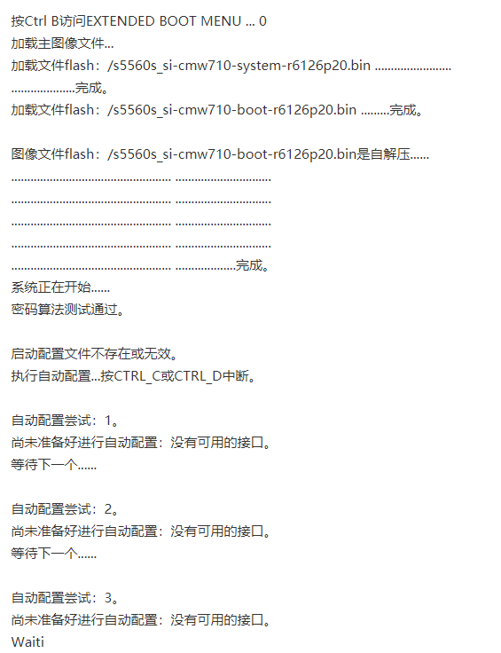

刚买的新交换机h3c s5560s-28p-si,第一次通电后就进入不了调试状态。securecrt工具显示的代码如下,请是什么原因?
2019-07-19提问
  • 1收藏,10666浏览
Starting......
Press Ctrl D to access BASIC BOOT MENU
Booting Normal Extend BootWare....
*                H3C S5560S-28P-SI Switch BOOTROM, Version 121                 *
Copyright (c) 2004-2018 New H3C Technologies Co., Ltd.
Creation Date       : May  4 2018, 16:17:55
CPU Clock Speed     : 800MHz
Memory Size         : 512MB
Flash Size          : 256MB
CPLD Version        : 001
PCB Version         : Ver.B
Mac Address         : 7057bfe16c43
Press Ctrl B to access EXTENDED BOOT MENU...0
Loading the main image files...
Loading file flash:/s5560s_si-cmw710-system-r6126p20.bin........................
....................Done.
Loading file flash:/s5560s_si-cmw710-boot-r6126p20.bin.........Done.
Image file flash:/s5560s_si-cmw710-boot-r6126p20.bin is self-decompressing......
.....................................................................Done.
System is starting...
Cryptographic algorithms tests passed.
Startup configuration file doesn't exist or is invalid.
Performing automatic configuration... Press CTRL_C or CTRL_D to break.
Automatic configuration attempt: 1.
Not ready for automatic configuration: no interface available.
Waiting for the next...
Automatic configuration attempt: 2.
Automatic configuration attempt: 3.
Waiti

新上电的设备由于是空配置启动,设备支持自动化上线功能,在未配置情况下需要
通过Press CTRL_C or CTRL_D 去跳过自动化配置,进入命令行视图

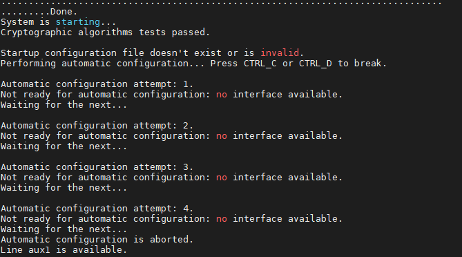

把CRT的波特率选为9600,数据流控都不选,进入后选择ctrl+c,如果还是这样现象,建议更换Console线测试。
粉丝:10人 关注:1人
按ctrl+c或者ctrl+d就进去了
