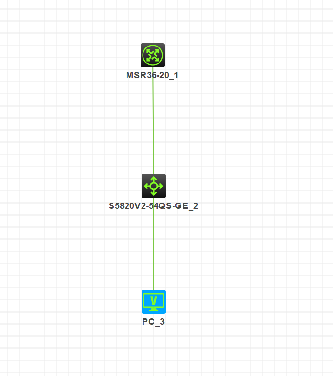

这样的拓扑中,一个路由器下来,连一台24口交换机,交换机1-8口获得172段地址,9-16获得100段,17-24获得200段,怎么操作呢?我在路由器中开启dhcp,交换机开启vlan,搭建trunk,不通

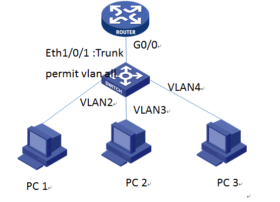

路由器上也要创建vlan,设置trunk,路由器型号为msr3620的话需要设备单臂路由,
路由器单臂路由配置
一、   组网图:
二、   路由器和交换机上面的配置:
interface GigabitEthernet0/1
 port link-mode route
interface GigabitEthernet0/1.1  //子接口1.1//
 vlan-type dot1q vid 4   //配置其子接口Vid为4//
 ip address 10.1.1.1 255.255.255.0  //设置下面vlan4内的客户端网关//
interface GigabitEthernet0/1.2  //子接口1.2//
 vlan-type dot1q vid 2
 ip address 10.1.2.1 255.255.255.0  //设置下面vlan2内的客户端网关//
interface GigabitEthernet0/1.3  //子接口1.3//
 vlan-type dot1q vid 3
 ip address 10.1.3.1 255.255.255.0  //设置下面vlan3内的客户端网关//
Return
交换机上面的配置:
vlan 1 to 4
interface Aux1/0/0
interface GigabitEthernet1/0/1  //和路由器互联口//
 port link-type trunk   //接口类型为TRUNK//
 port trunk permit vlan all  //允许所有vlan通过//
 port access vlan 2
 port access vlan 2
interface GigabitEthernet1/0/4
 port access vlan 2
interface GigabitEthernet1/0/5
 port access vlan 2
interface GigabitEthernet1/0/6
 port access vlan 2
interface GigabitEthernet1/0/7
interface GigabitEthernet1/0/8
interface GigabitEthernet1/0/9
interface GigabitEthernet1/0/10
 port access vlan 3
interface GigabitEthernet1/0/11
 port access vlan 3
interface GigabitEthernet1/0/12
 port access vlan 3
interface GigabitEthernet1/0/13
 port access vlan 3
interface GigabitEthernet1/0/14
 port access vlan 3
interface GigabitEthernet1/0/15
 port access vlan 3
interface GigabitEthernet1/0/16
 port access vlan 3
interface GigabitEthernet1/0/17
 port access vlan 3
interface GigabitEthernet1/0/18
 port access vlan 3
interface GigabitEthernet1/0/19
interface GigabitEthernet1/0/20
 port access vlan 4
interface GigabitEthernet1/0/21
 port access vlan 4
interface GigabitEthernet1/0/22
 port access vlan 4

在路由器上开启dhcp也行,配置正确的话,也能通,但明显这样的拓扑规划不合理,建议把所有vlan和vlan接口地址建在交换机上,5820是三层交换机,且支持dhcp server,例如:
1,划分好相关vlan,将相关接口加入vlan
2,创建vlan接口地址
3,开启dhcp服务,创建dhcp地址池
 dhcp enable
dhcp server ip-pool 2
 gateway-list 192.168.2.1
 network 192.168.2.0 mask 255.255.255.0
 dns-list 114.114.114.114 8.8.8.8
4,创建互联vlan,将缺省路由指向路由接口地址,路由器设置回程路由
