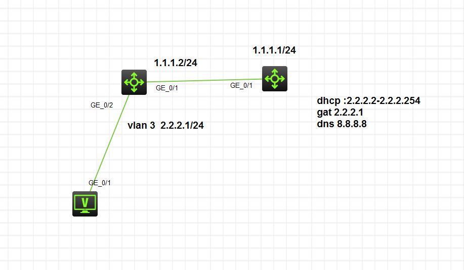

我给你测试下然后发配置过来,等下哈
server: # dhcp enable # # dhcp server ip-pool vlan3 gateway-list 2.2.2.1 network 2.2.2.0 mask 255.255.255.0 dns-list 8.8.8.8 # # ip route-static 2.2.2.0 24 1.1.1.2 # relay: # dhcp enable # # interface Vlan-interface3 ip address 2.2.2.1 255.255.255.0 dhcp select relay dhcp relay server-address 1.1.1.1 # 现象: [server]dis dhcp server ip-in-use IP address Client identifier/ Lease expiration Type Hardware address 2.2.2.2 0030-3466-392e-6130- Jan 2 01:34:03 2018 Auto(C) 3138-2e30-3330-352d- 4745-302f-30 [server]

谢谢,我应该是回程路由没有做,我ping 1.1.1.1 通了,以为路由OK了,返过来Ping2.2.2.1 不通,增加路由就通了,
