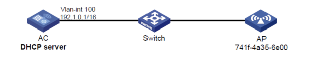

如图1所示,AC作为DHCP服务器为AP分配IP地址,现要求使用自动AP功能,实现AP与AC自动关联,并且在关联后将AP转化为固化AP。

2.1  AC的配置
(1) 在AC上配置相关VLAN,并放通对应接口,开启DHCP server功能,AP
通过DHCP server自动获取IP地址。
(2) 开启自动AP功能和AP自动固化功能。
[AC] wlan auto-ap enable
[AC] wlan auto-persistent enable
2.2  Switch的配置
# 创建相关VLAN,配置L2 switch和AP相连的接口为Trunk类型,PVID为AP 管理VLAN,并开启PoE供电功能。
3  验证配置
# 通过display wlan ap all命令可以看到AC与AP建立连接,AP的状态为Run。
[AC] display wlan ap all
Total number of APs: 1
Total number of connected APs: 1
Total number of connected manual APs: 1
Total number of connected auto APs: 0
Total number of connected common APs: 1
Total number of connected WTUs: 0
Total number of inside APs: 0
Maximum supported APs: 3072
Remaining APs: 3071
Total AP licenses: 128
Remaining AP licenses: 127
 AP information
 State : I = Idle, J  = Join, JA = JoinAck, L = ImageLoad
         C = Config, DC = DataCheck,  R  = Run, M = Master,  B = Backup
AP name   AP ID   State   Model             Serial ID
741f-4a35-6e00  1  R/M  WA4320-ACN-SI   219801A0T78156A00049
粉丝:24人 关注:2人
设备默认开启自动注册,保障ap能够拿到地址并且和ac可以通信即可
