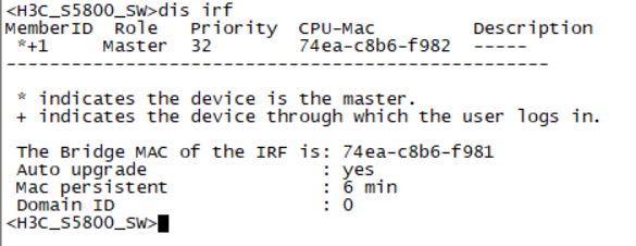

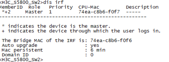

两台5800用一根光纤做堆叠,安装这个命令配置irf member 1 priority 32 ; int Ten-GigabitEthernet 1/0/28; irf-port 1/1; port group interface Ten-GigabitEthernet 1/0/28; int Ten-GigabitEthernet 1/0/28; irf-port-configuration active;主的32,副的2,使用dis irf 查看的时候就显示一台,请问是哪里配置部队还是有遗漏

堆叠没成功,故而显示一台
参考下述1.9典型案例配置,解决请采纳: http://www.h3c.com/cn/d_201510/895942_30005_0.htm

物理端口是否up?irf-port是否交叉?
