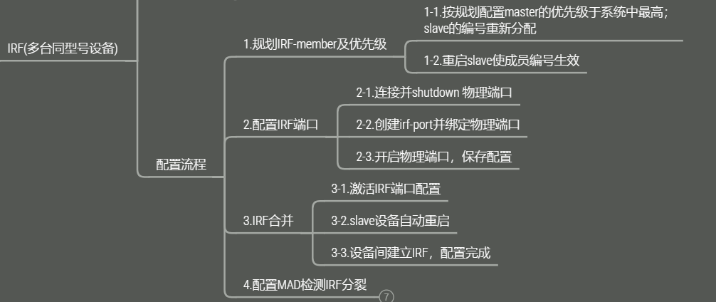

参考下述1.9典型案例配置,解决请采纳:
http://www.h3c.com/cn/d_201510/895942_30005_0.htm

堆叠配置案例:
A:
irf member 1
irf priority 10
int ten-g 2/0/8
 shutdown
 undo shutdown
irf-port 2
 port group inter ten-g 2/0/8
int ten-g 2/0/8
 shutdown
 undo shutdown
save
chassis convert mode irf
B:
irf member 2
int ten-g 2/0/8
 shutdown
 undo shutdown
irf-port 1
int ten-g 2/0/8
 shutdown
 undo shutdown
save
最好至少采用两个口来堆叠,否则的话,一条线路断了,堆叠分裂,就无法冗余了
粉丝:2人 关注:1人
具体配置命令到官网查一下,挺少的
