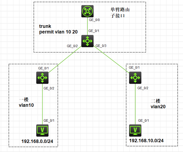

单臂路由+DHCP,问题:
1、PC无法获取动态IP地址,且不通;
2、PC配置对应Vlan的IP地址,也不通。
路由器配置:
 dhcp enable
 dhcp server ip-pool vlan10
 gateway-list 192.168.0.1
 network 192.168.0.0 mask 255.255.255.0
 forbidden-ip 192.168.0.1
 dhcp server ip-pool vlan20
 gateway-list 192.168.10.1
 network 192.168.10.0 mask 255.255.255.0
 forbidden-ip 192.168.10.1
interface GigabitEthernet0/0
 port link-mode route
 description Link_SW
 combo enable copper
interface GigabitEthernet0/0.1
ip address 192.168.0.1 255.255.255.0
 vlan-type dot1q vid 10
 dhcp server apply ip-pool vlan10
interface GigabitEthernet0/0.2
 ip address 192.168.10.1 255.255.255.0
 vlan-type dot1q vid 20
 dhcp server apply ip-pool vlan20
核心交换机配置:
vlan 10 description Fir_Floor
vlan 20 description Sec_Floor
 port link-mode bridge
 description Link_MSR
 port link-type trunk
 port trunk permit vlan all
 combo enable fiber
 port link-type hybrid
 undo port hybrid vlan 1
 port hybrid vlan 10 untagged
 port hybrid pvid vlan 10
 combo enable fiber
 port hybrid vlan 20 untagged
 port hybrid pvid vlan 20
 combo enable fiber
接入交换机,无任何配置,保持默认状态,

将交换机的2号口和3号口配置成access VLAN10 和Vlan20
之前尝试过是不通的
