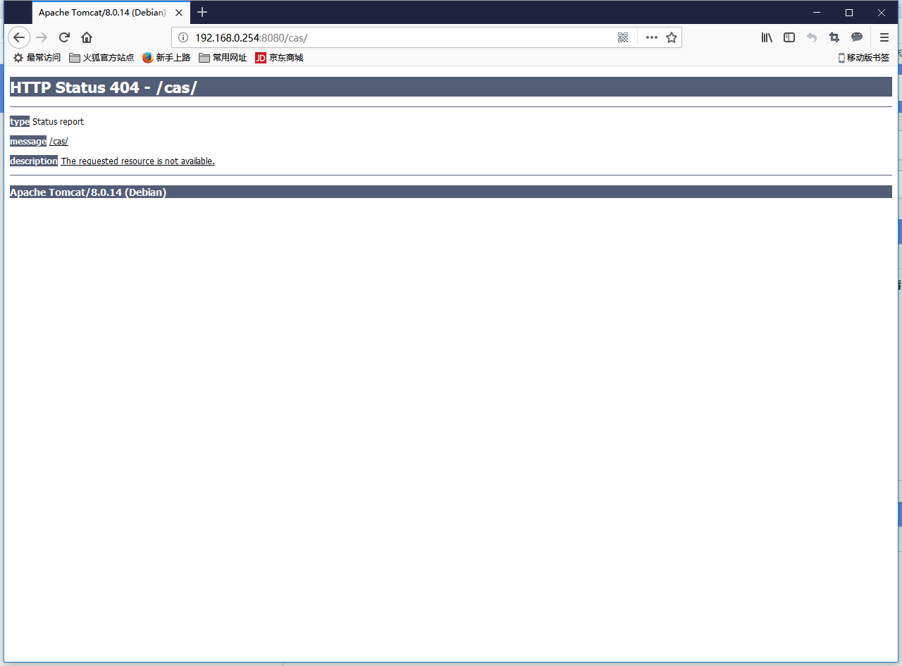

我在VMware Worktsation 14里头安装了CVM,然后在火狐浏览器里头输入http://192.168.0.254:8080,提示如图错误,请问该怎么解决呢?

CAS E0306及以后版本不支持workstation安装,不用费劲了,不支持的,只能用CAS虚拟机或者物理机,码字不易望采纳!

确认安装时勾选了CVM组件吗
一、确认cvm、cic组件是否正常安装
后台SSH登陆CVM主机的命令行
cd /var/lib/tomcat8/webapps/ root@B590:/var/lib/tomcat6/webapps# ll
total 371596
drwxrwxr-x  8 tomcat6 tomcat6      4096 Dec  6 14:53 ./
drwxr-xr-x  7 root    root         4096 Dec  6 14:43 ../
drwxr-xr-x 12 root    root         4096 Dec  6 14:53 cas/
-rw-r--r--  1 root    root    123930786 Oct 30 20:50 cas.war
drwxr-xr-x 12 tomcat6 tomcat6      4096 Dec  6 14:44 cic/
drwxr-xr-x  4 tomcat6 tomcat6      4096 Dec  6 14:44 cichelp/
-rw-r--r--  1 root    root     14236376 Oct 30 20:50 cichelp.war
-rw-r--r--  1 root    root    134279616 Oct 30 20:50 cic.war
drwxr-xr-x  4 tomcat6 tomcat6      4096 Dec  6 14:43 cvmhelp/
-rw-r--r--  1 root    root     13363977 Oct 30 20:50 cvmhelp.war
drwxr-xr-x  3 tomcat6 tomcat6      4096 Dec  6 14:43 ROOT/
drwxr-xr-x 13 tomcat6 tomcat6      4096 Dec  6 14:44 ssv/
-rw-r--r--  1 root    root     94661773 Oct 30 20:50 ssv.war
cas.war     安装了CVM
cic.war      安装了CIC
ssv.war     安装了SSV
二、如果正常安装CVM,重启tomcat服务
root@cvknode197:~# service  tomcat6 restart
 * Stopping Tomcat servlet engine tomcat6
   ...done.
 * Starting Tomcat servlet engine tomcat6
   ...done.
三、重启之后不行,清除缓存之后重启casserver,tomcat6
cd /var/lib/tomcat6/webapps/ root@B590:/var/lib/tomcat6/webapps# ll
total 371596
     删除cas缓存
     rm -r cas
     重启casserver和tomcat6
     service casserver restart
按照评论里面顺序检查来一遍

勾选了CVM组件
panakot帕纳克 发表时间:2018-01-12
按照评论里面顺序检查来一遍
