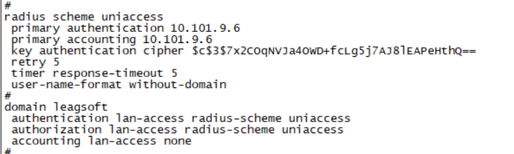

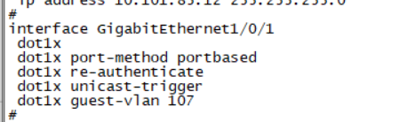

现网有一批5130S-28P-EI设备,要与联软科技的准入软件做802.1X认证对接,现在发现在domain下认证参数指向radius 授权参数为none、计费参数为none情况下,客户端能认证成功,但radius服务器下发的vlan,在交换机上授权失败,接入端口进入了端口下的默认vlan;在domain下认证、授权参数都指向radius,计费为none情况下,客户端有一瞬间能认证成功,但立刻就显示认证失败了。有哪位大神处理过类似情况吗?相关截图信息如下;在debug下有看到这个信息,:*Jan 25 17:52:26:688 2013 B车间_3f_01 DOT1X/7/EVENT: Sent authorization request: UserMAC=4439-c433-b3e8, VLANID=107, Interface=GigabitEthernet1/0/1. *Jan 25 17:52:26:688 2013 B车间_3f_01 RADIUS/7/EVENT: PAM_RADIUS: Processing RADIUS authorization. *Jan 25 17:52:26:688 2013 B车间_3f_01 RADIUS/7/EVENT: PAM_RADIUS: RADIUS Authorization successfully. *Jan 25 17:52:26:694 2013 B车间_3f_01 RADIUS/7/EVENT: Sent reply message successfully. *Jan 25 17:52:26:708 2013 B车间_3f_01 DOT1X/7/EVENT: AAA processed authorization request: Result= Failure, UserMAC=4439-c433-b3e8, VLANID=107, Interface=GigabitEthernet1/0/1.

计费也指定服务器正常吗
BFG 二段
粉丝:1人 关注:1人
不正常

接口下配置:
undo dot1x multicast-trigger
Undo dot1x handshake
尝试是否可以正常连接
