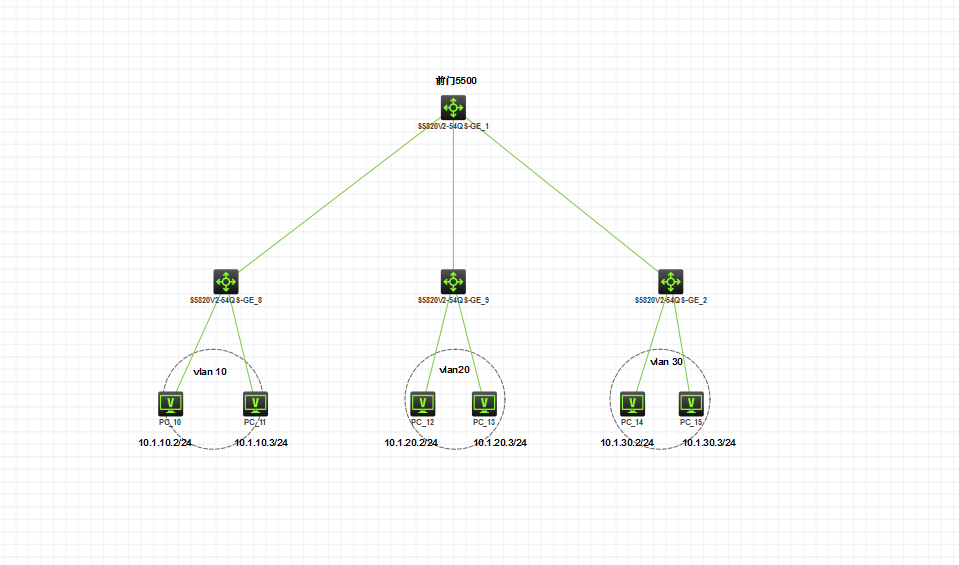

VLAN划分
2019-09-23提问
  • 1收藏,2219浏览
Destination/Mask  Proto     Pre   Cost     NextHop    Interface
0.0.0.0/32            Direct         0        0       127.0.0.1    InLoop0
 10.1.30.0/24      Direct           0        0       10.1.30.1    Vlan30
10.1.30.0/32       Direct          0         0       10.1.30.1         Vlan30
10.1.30.1/32       Direct           0            0    127.0.0.1      InLoop0
10.1.30.255/32     Direct         0            0      10.1.30.1         Vlan30
 127.0.0.0/8         Direct     0      0              127.0.0.1       InLoop0
 127.0.0.0/32       Direct     0        0             127.0.0.1   InLoop0
127.0.0.1/32       Direct        0     0           127.0.0.1      InLoop0
127.255.255.255/32   Direct     0    0              127.0.0.1 InLoop0
 224.0.0.0/4            Direct     0  0.0.0.0         NULL0
 224.0.0.0/24        Direct         0 0               0.0.0.0           NULL0
 255.255.255.255/32 D   irect 0 0                127.0.0.1    InLoop0
我也配置了VLAN10的ip VLAN 20的IP  但是我在路由表中没有出现vlan10 VLAN20 的直连路由呢
[sw4]dis vlan 20 VLAN ID: 20 VLAN type: Static Route interface: Configured IPv4 address: 10.1.20.1 IPv4 subnet mask: 255.255.255.0 Description: VLAN 0020 Name: VLAN 0020 Tagged ports: None Untagged ports: GigabitEthernet1/0/2
[sw4]dis vlan 10 VLAN ID: 10 VLAN type: Static Route interface: Configured IPv4 address: 10.1.10.1 IPv4 subnet mask: 255.255.255.0 Description: VLAN 0010 Name: VLAN 0010 Tagged ports: None Untagged ports: GigabitEthernet1/0/1

您看一下vlan 10和20的对应接口up了吗
好奇怪啊,我模拟机都开启的
zhiliao_qtgKm 发表时间:2019-09-23 更多>>
怎么看呢谢谢
dis ip int b 看对应的两个接口状态是不是up
撇撇种土豆 发表时间:2019-09-23
不是,是down 怎么修改呢
那说明您这两个vlan里面没有终端接入,找两台电脑分别接入到两个vlan中就行了
