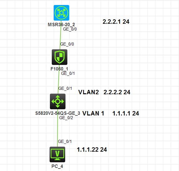

防火墙当透传里面需要配置那些东西
下面是我配的,缺哪些东西
interface Vlan-interface100
 ip address 10.1.1.1 255.255.255.0  (管理地址)
interface GigabitEthernet1/0/0
 port link-mode bridge
 port link-type trunk
 port trunk permit vlan 1 100
 combo enable copper
 combo enable copper
zone-pair security source Trust destination Untrust
 packet-filter 2000
 zone-pair security source Untrust destination Trust
 packet-filter 2000
acl basic 2000
 rule 0 permit  any
security-zone name Trust
 import interface Vlan-interface100
 import interface GigabitEthernet1/0/1 vlan 100
security-zone name Untrust
 import interface GigabitEthernet1/0/0 vlan 100
配置完成后,路由器上的端口是DOWN的  我错配置什么东西了吗

线插错了?
接口起来了 现在还是不同 ping 2.2.2.2都不同
