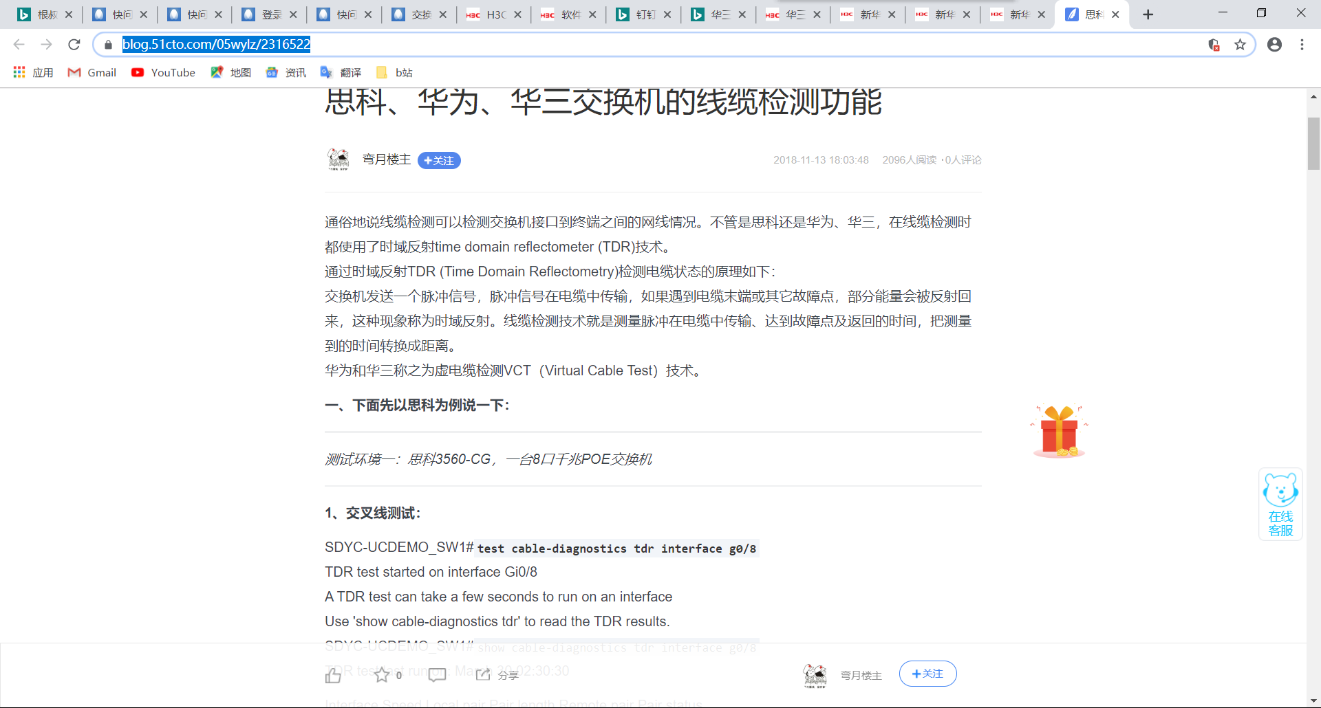

有的,如下:
https://blog.51cto.com/05wylz/2316522
   [core-S5560-1-GigabitEthernet1/0/1]virtual-cable-test
