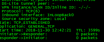

telnet是tcp服务,最终正常稳定状态是TCP_ESTABLISHED

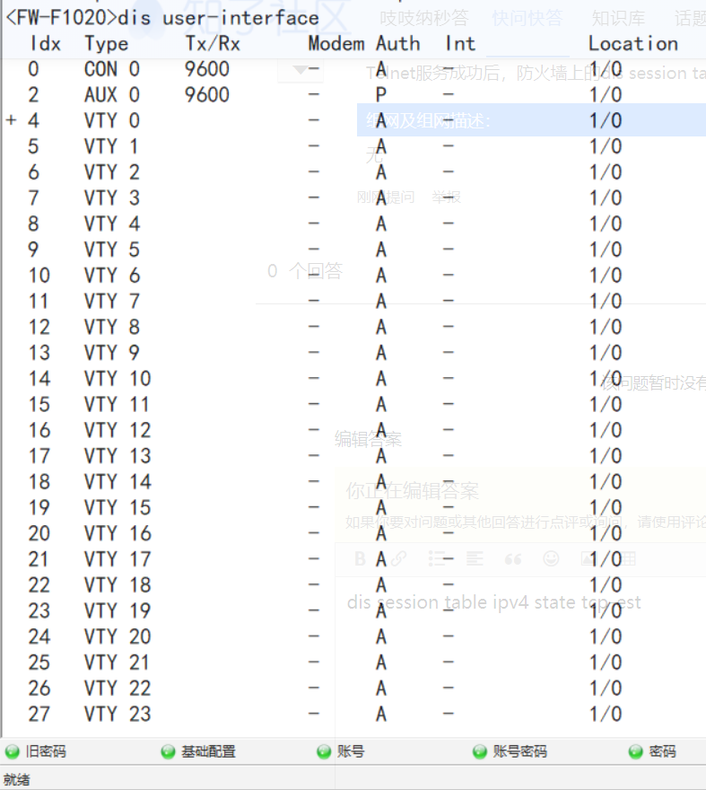

dis session table ipv4 state tcp-est
dis user-interface
  + : Line is active.
 F : Line is active and in async mode.
 Idx : Absolute index of line.
 Type : Type and relative index of line.
 Auth : Login authentication mode.
 Int : Physical port of the line.
 A : Authentication use AAA.
 N : No authentication is required.
 P : Password authentication.

会话状态??查会话表里面的会话状态是什么
zhiliao_Assmu 发表时间:2019-10-26
