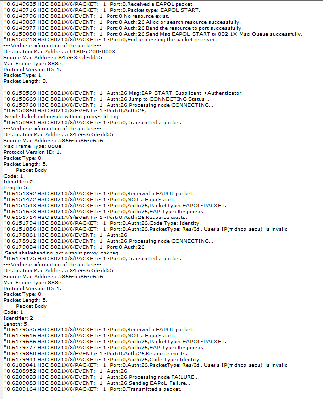

问题:802.1x认证,终端给交换机发送eap-response/id后,交换机没有响应了,8021x流程没有走完,日志也没有打印;
(radius配置是正常的,使用win网卡的8021x身份验证,认证流程是正常的;)
交换机debug
*0.6149635 H3C 8021X/8/PACKET:- 1 -Port:0,Received a EAPOL packet. *0.6149716 H3C 8021X/8/PACKET:- 1 -Port:0,Packet type: EAPOL-START. *0.6149796 H3C 8021X/8/EVENT:- 1 -Port:0,No resource exist. *0.6149867 H3C 8021X/8/EVENT:- 1 -Port:0,Auth:26,Alloc or search resource successfully. *0.6149977 H3C 8021X/8/EVENT:- 1 -Port:0,Auth:26,Band the resource to port successfully. *0.6150088 H3C 8021X/8/EVENT:- 1 -Port:0,Auth:26,Send Msg EAPOL-START to 802.1X-Msg-Queue successfully. *0.6150218 H3C 8021X/8/PACKET:- 1 -Port:0,End processing the packet received. ---Verbose information of the packet--- Destination Mac Address: 0180-c200-0003 Source Mac Address: 84a9-3e5b-dd55 Mac Frame Type: 888e. Protocol Version ID: 1. Packet Type: 1. Packet Length: 0. *0.6150569 H3C 8021X/8/EVENT:- 1 -Auth:26,Msg:EAP-START, Supplicant->Authenticator. *0.6150669 H3C 8021X/8/EVENT:- 1 -Auth:26,Jump to CONNECTING Status ... *0.6150760 H3C 8021X/8/EVENT:- 1 -Auth:26,Processing node CONNECTING... *0.6150860 H3C 8021X/8/EVENT:- 1 -Port:0,Auth:26, Send shakehanding-pkt without proxy-chk tag *0.6150981 H3C 8021X/8/PACKET:- 1 -Port:0,Transmitted a packet. ---Verbose information of the packet--- Destination Mac Address: 84a9-3e5b-dd55 Source Mac Address: 5866-ba86-e656 Mac Frame Type: 888e. Protocol Version ID: 1. Packet Type: 0. Packet Length: 5. -----Packet Body----- Code: 1. Identifier: 2. Length: 5. *0.6151392 H3C 8021X/8/PACKET:- 1 -Port:0,Received a EAPOL packet. *0.6151472 H3C 8021X/8/PACKET:- 1 -Port:0,NOT a Eapol-start. *0.6151543 H3C 8021X/8/PACKET:- 1 -Port:0,Auth:26,PacketType: EAPOL-PACKET. *0.6151633 H3C 8021X/8/PACKET:- 1 -Port:0,Auth:26,EAP Type: Response. *0.6151714 H3C 8021X/8/EVENT:- 1 -Port:0,Auth:26,Resource exists. *0.6151794 H3C 8021X/8/PACKET:- 1 -Port:0,Auth:26,Code Type: Identity. *0.6151886 H3C 8021X/8/PACKET:- 1 -Port:0,Auth:26,PacketType: Res/Id . User's IP(fr dhcp-secu) is invalid *0.6178861 H3C 8021X/8/EVENT:- 1 -Auth:26, *0.6178912 H3C 8021X/8/EVENT:- 1 -Auth:26,Processing node CONNECTING... *0.6179004 H3C 8021X/8/EVENT:- 1 -Port:0,Auth:26, Send shakehanding-pkt without proxy-chk tag *0.6179125 H3C 8021X/8/PACKET:- 1 -Port:0,Transmitted a packet. ---Verbose information of the packet--- Destination Mac Address: 84a9-3e5b-dd55 Source Mac Address: 5866-ba86-e656 Mac Frame Type: 888e. Protocol Version ID: 1. Packet Type: 0. Packet Length: 5. -----Packet Body----- Code: 1. Identifier: 2. Length: 5. *0.6179535 H3C 8021X/8/PACKET:- 1 -Port:0,Received a EAPOL packet. *0.6179616 H3C 8021X/8/PACKET:- 1 -Port:0,NOT a Eapol-start. *0.6179686 H3C 8021X/8/PACKET:- 1 -Port:0,Auth:26,PacketType: EAPOL-PACKET. *0.6179777 H3C 8021X/8/PACKET:- 1 -Port:0,Auth:26,EAP Type: Response. *0.6179860 H3C 8021X/8/EVENT:- 1 -Port:0,Auth:26,Resource exists. *0.6179941 H3C 8021X/8/PACKET:- 1 -Port:0,Auth:26,Code Type: Identity. *0.6180041 H3C 8021X/8/PACKET:- 1 -Port:0,Auth:26,PacketType: Res/Id . User's IP(fr dhcp-secu) is invalid *0.6208952 H3C 8021X/8/EVENT:- 1 -Auth:26, *0.6209003 H3C 8021X/8/EVENT:- 1 -Auth:26,Processing node FAILURE... *0.6209083 H3C 8021X/8/EVENT:- 1 -Auth:26,Sending EAPoL-Failure... *0.6209164 H3C 8021X/8/PACKET:- 1 -Port:0,Transmitted a packet.

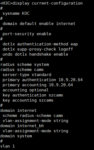

交换机配置:

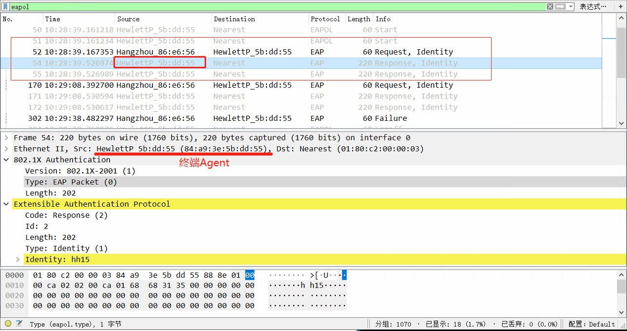

找到原因了,我司的代理在response/id报文中加了点设备信息,v3版本的交换机不支持识别没有处理
