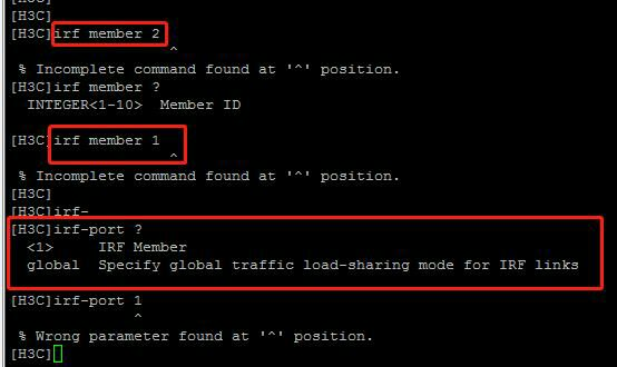

IRF报错
2020-02-07提问
  • 1收藏,2518浏览
IRF报错
粉丝:8人 关注:0人
IRF成员1:
主设备配置过程:
irf member 1 renumber 1
chassiss convert mode irf
reboot
3.重启完成后,先关闭需要堆叠的物理端口。
int ten 1/0/1
shutdown
int ten 1/0/2
shutdown
4.将物理端口捆绑放堆叠端口
irf-port 1/1
port group interface ten 1/0/1
port group interface ten 1/0/2
5.开启物理端口
int ten 1/0/1
undo shutdown
int ten 1/0/2
undo shutdown
6.激活irf
irf-port-configuration active
7.保存配置。
IRF成员2:
备用设备配置过程:
irf member 1 renumber 2
reboot
int ten 2/0/1
shutdown
int ten 2/0/2
shutdown
4.将物理端口捆绑放堆叠端口
irf-port 2/2
port group interface ten 2/0/1
port group interface ten 2/0/2
5.开启物理端口
int ten 2/0/1
undo shutdown
int ten 2/0/2
undo shutdown
6.激活irf
7.保存配置。
您使用的应该是H3C HCL模拟器的S5820做的IRF,可参考如下配置过程:
1、1号设备关键配置如下:
[H3C]irf member 1 renumber 1     //将1号设备设定为成员1
Renumbering the member ID may result in configuration change or loss. Continue?[Y/N]:y
[H3C]int range Ten-GigabitEthernet 1/0/50 to Ten-GigabitEthernet 1/0/51
[H3C-if-range]shutdown
[H3C-if-range]quit
[H3C]irf-port 1/1  //将物理端口绑定到IRF端口
[H3C-irf-port1/1]port group interface Ten-GigabitEthernet 1/0/50
[H3C-irf-port1/1]port group interface Ten-GigabitEthernet 1/0/51
[H3C-irf-port1/1]quit
[H3C-if-range]undo shutdown
[H3C-if-range]quit
[H3C]irf-port-configuration active  //激活IRF
[H3C]save
2、2号设备关键配置点如下:
[H3C]irf member 1 renumber 2  //将2号设备设定为成员2
[H3C-if-range]quit
[H3C]irf-port 1/2  //将物理端口绑定到IRF端口
[H3C-irf-port1/2]port group interface Ten-GigabitEthernet 1/0/50
[H3C-irf-port1/2]port group interface Ten-GigabitEthernet 1/0/51
[H3C-irf-port1/2]quit
[H3C-if-range]quit
[H3C]save
