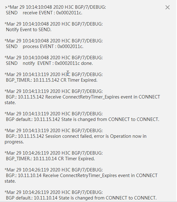

 *Mar 29 10:15:12:119 2020 H3C BGP/7/DEBUG: BGP.: 10.11.15.142 Receive ConnectRetryTimer_Expires event in CONNECT state. *Mar 29 10:15:12:119 2020 H3C BGP/7/DEBUG: BGP default.: 10.11.15.142 State is changed from CONNECT to CONNECT. *Mar 29 10:15:12:119 2020 H3C BGP/7/DEBUG: BGP.: 10.11.15.142 Session connect failed, error is Operation now in progress. *Mar 29 10:15:22:119 2020 H3C BGP/7/DEBUG: BGP_TIMER.: 10.11.10.14 CR Timer Expired. *Mar 29 10:15:22:119 2020 H3C BGP/7/DEBUG: BGP.: 10.11.10.14 Receive ConnectRetryTimer_Expires event in CONNECT state. *Mar 29 10:15:22:119 2020 H3C BGP/7/DEBUG: BGP default.: 10.11.10.14 State is changed from CONNECT to CONNECT. *Mar 29 10:15:22:119 2020 H3C BGP/7/DEBUG: BGP.: 10.11.10.14 Session connect failed, error is No route to host.

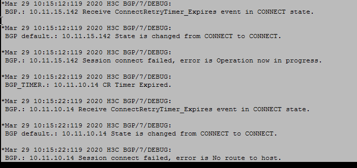

*Mar 29 10:36:23:119 2020 H3C BGP/7/DEBUG: BGP default.: 10.11.10.14 State is changed from CONNECT to CONNECT. *Mar 29 10:36:23:120 2020 H3C BGP/7/DEBUG: BGP.: 10.11.10.14 Session connect failed, error is Operation now in progress.
