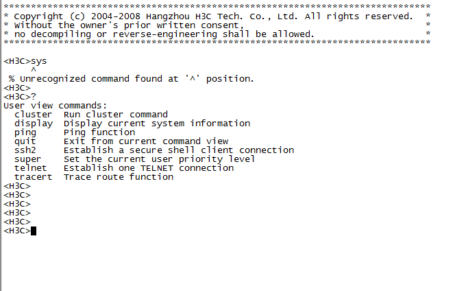

S3610+ssh连上后发现敲sys不认,敲?只能看到User view commands:

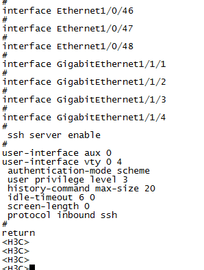

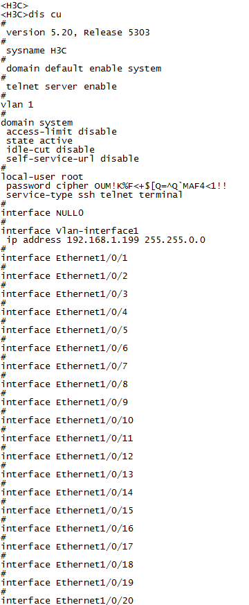

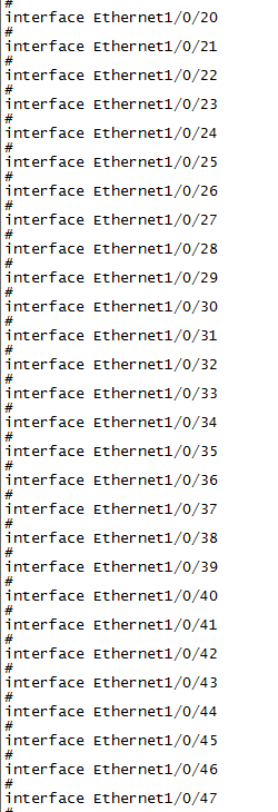

我用控制串口连上配置了以下内容:
<H3C> <H3C>dis cu # version 5.20, Release 5303 # sysname H3C # domain default enable system # telnet server enable # vlan 1 # domain system access-limit disable state active idle-cut disable self-service-url disable # local-user root password cipher OUM!K%F<+$[Q=^Q`MAF4<1!! service-type ssh telnet terminal # interface NULL0 # interface Vlan-interface1 ip address 192.168.1.199 255.255.0.0 # interface Ethernet1/0/1 # interface Ethernet1/0/2 # interface Ethernet1/0/3 # interface Ethernet1/0/4 # interface Ethernet1/0/5 # interface Ethernet1/0/6 # interface Ethernet1/0/7 # interface Ethernet1/0/8 # interface Ethernet1/0/9 # interface Ethernet1/0/10 # interface Ethernet1/0/11 # interface Ethernet1/0/12 # interface Ethernet1/0/13 # interface Ethernet1/0/14 # interface Ethernet1/0/15 # interface Ethernet1/0/16 # interface Ethernet1/0/17 # interface Ethernet1/0/18 # interface Ethernet1/0/19 # interface Ethernet1/0/20 # interface Ethernet1/0/21 # interface Ethernet1/0/22 # interface Ethernet1/0/23 # interface Ethernet1/0/24 # interface Ethernet1/0/25 # interface Ethernet1/0/26 # interface Ethernet1/0/27 # interface Ethernet1/0/28 # interface Ethernet1/0/29 # interface Ethernet1/0/30 # interface Ethernet1/0/31 # interface Ethernet1/0/32 # interface Ethernet1/0/33 # interface Ethernet1/0/34 # interface Ethernet1/0/35 # interface Ethernet1/0/36 # interface Ethernet1/0/37 # interface Ethernet1/0/38 # interface Ethernet1/0/39 # interface Ethernet1/0/40 # interface Ethernet1/0/41 # interface Ethernet1/0/42 # interface Ethernet1/0/43 # interface Ethernet1/0/44 # interface Ethernet1/0/45 # interface Ethernet1/0/46 # interface Ethernet1/0/47 # interface Ethernet1/0/48 # interface GigabitEthernet1/1/1 # interface GigabitEthernet1/1/2 # interface GigabitEthernet1/1/3 # interface GigabitEthernet1/1/4 # ssh server enable # user-interface aux 0 user-interface vty 0 4 authentication-mode scheme user privilege level 3 history-command max-size 20 idle-timeout 6 0 screen-length 0 protocol inbound ssh # return <H3C> <H3C>
再截下图
ssh2只能连到这里,为啥不能敲sys啊,,

您的权限应该不够,所以无法进入系统视图。
建议增加一条配置:
authorization-attribute user-role network-admin

兄die,用户没设置权限:
给这个用户添加一条命令:
或者是:
authorization-attribute  level 3
满意请采纳。
直接敲level 3看看

你的账号的权限不够,应该被限制了,只能敲那几个命令

兄弟你SSH登录的账号权限不够,在账号下加上authorization-attribute  leve  3
你的设备版本太老了,直接Leve 3 就可以了

非常感谢各位老师的解答,我根据你们的讲解,我试试了下,关键底下没有这个authorization-attribute的命令啊
回复dayday_up:
加上level3 确实可以了。 多谢各位老师的指点!非常感谢,这个论坛是我见过回答比较快的论坛,对于各位华三公司的老师们,表示感谢!
zhiliao_QLm4f4 发表时间:2020-04-10 更多>>
那就是直接敲level 3
dayday_up 发表时间:2020-04-10
直接Leve 3 就可以了
