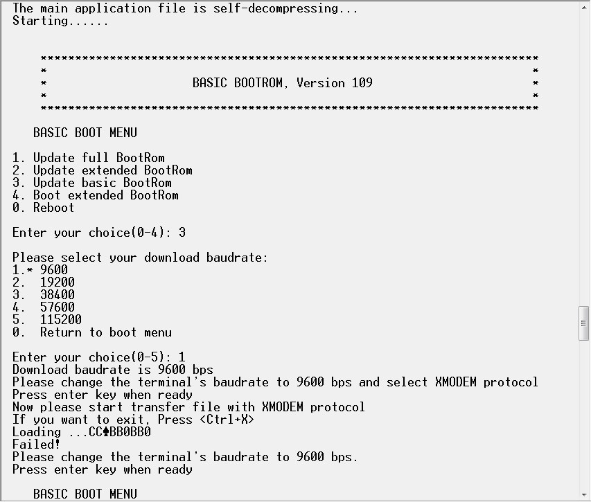

S3100V226TPEI bootrom密码忘记,需要如何处理?console口启动时,只能到这样的步骤。

2、升级方法:
上电重启的时候,按住ctrl+D,选择全部升级,串口升级:
Enter your choice(0-9): 0
Starting......
    *                     BASIC BOOTROM, Version 136                       *
   BASIC BOOT MENU
1. Update full BootRom
2. Update extended BootRom
3. Update basic BootRom
4. Boot extended BootRom
0. Reboot
Enter your choice(0-4): 1
Please select your download baudrate:
1.  9600
2.  19200
3.  38400
4.  57600
5.* 115200
0.  Return to boot menu
Enter your choice(0-5):
Download baudrate is 115200 bps
Please change the terminal's baudrate to 115200 bps and select XMODEM protocol
Press enter key when ready
3、把串口接到波特率为115200的的终端上,xmodem模式传递新的179bootware
Now please start transfer file with XMODEM protocol
If you want to exit, Press <Ctrl+X>
Loading ...CCCCCCCCCCCCCC
Starting xmodem transfer.  Press Ctrl+C to cancel.
Transferring S5120SI_2900-9-BTM-179.btm...
  100%     279 KB       7 KB/sec    00:00:39       0 Errors
Will you Update Basic BootRom? (Y/N):Y
Updating Basic BootRom...Done!
