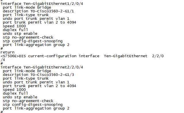

7506E对接cisco3560;口字型互联,开始都是正常的,但突然有一天出现了问题:Cisco两个接口都是UP的,但是75侧只起来一个接口,导致内网部分服务器有问题;手动关闭故障接口后业务恢复;有谁遇到过相同问题的,该如何解决呢?
75对接3560时,75配置如下:
35配置如下:

补充下,设备提示日志如下:
%Apr 24 11:42:00:700 2020 S7506E LAGG/6/LAGG_INACTIVE_PHYSTATE: Member port XGE1/2/0/4 of aggregation group BAGG2 changed to the inactive state, because the physical state of the port is down. %Apr 24 11:42:00:671 2020 S7506E IFNET/3/PHY_UPDOWN: Physical state on the interface Ten-GigabitEthernet1/2/0/4 changed to down.
但这段时间没有做过任何配置修改
