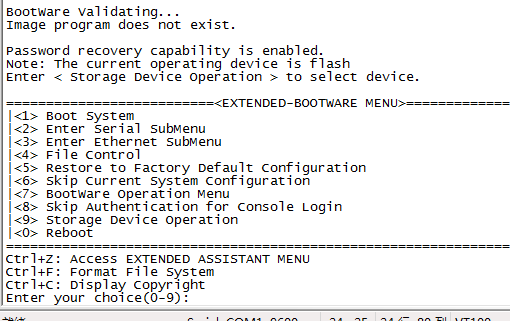

请问这个AC控制器,我准备软件升级一下,但是通过console口连接进入 到下面的界面,我该怎么操作,请指导一下,谢谢!

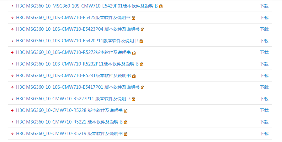

软件丢失了,重新下载个上传上去吧,升级文档和软件下载地址:
https://www.h3c.com/cn/Service/Document_Software/Software_Download/IP_Wlan/MSG/MSG360_10/
用户名:yx800   密码:01230123
粉丝:57人 关注:0人
参考案例轻轻松松配无线:https://zhiliao.h3c.com/topic/huati/1249
zhiliao_OloNd 知了小白
这些版本都可以用吗?

B.5.2 进入BootWare菜单
1. BootWare主菜单
设备上电和重新启动的过程中,在配置终端的屏幕上首先将显示:
System is starting...
Press Ctrl+D to access BASIC-BOOTWARE MENU
Press Ctrl+T to start heavy memory test
Booting Normal Extended BootWare
The Extended BootWare is self-decompressing....Done.
*                   H3C WX3520H BootWare, Version 1.10                     *
Copyright (c) 2004-2018 New H3C Technologies Co., Ltd.
Compiled Date       : Apr 23 2018
CPU Type            : XLP416
CPU Clock Speed     : 1000MHz
Memory Type         : DDR3 SDRAM
Memory Size         : 4096MB
Memory Speed        : 1333MHz
BootWare Size       : 768KB
Flash Size          : 16MB
cfa0 Size           : 4002MB
CPLD1 Version       : 004
CPLD2 Version       : 000
PCB Version         : Ver.A
BootWare Validating...
Press Ctrl+B to access EXTENDED-BOOTWARE MENU...
说明
·         为了阅读和便于理解,如果不做特殊说明,本菜单都将称为BootWare主菜单。
·         以上显示信息与设备实际情况相关,可能会略有差别。
当出现“Press Ctrl+B to access EXTENDED-BOOTWARE MENU...”时,键入<Ctrl+B>,系统进入BootWare主菜单:
Password recovery capability is enabled.
Note: The current operating device is cfa0
Enter < Storage Device Operation > to select device.
===========================<EXTENDED-BOOTWARE MENU>===========================
|<1> Boot System                                                           |
|<2> Enter Serial SubMenu                                                  |
|<3> Enter Ethernet SubMenu                                                |
|<4> File Control                                                          |
|<5> Restore to Factory Default Configuration                              |
|<6> Skip Current System Configuration                                     |
|<7> BootWare Operation Menu                                               |
|<8> Skip Authentication for Console Login                                 |
|<9> Storage Device Operation                                              |
|<0> Reboot                                                                |
Ctrl+Z: Access EXTENDED ASSISTANT MENU
Ctrl+F: Format File System
Ctrl+C: Display Copyright
Enter your choice(0-9):

B.5.4 通过以太网口利用TFTP/FTP升级启动文件
(1)       以太网口参数配置:在BootWare主菜单下键入<3>可以进入以太网操作子菜单,然后键入<5>就可以进入以太网参数设置菜单:
=========================<ETHERNET PARAMETER SET>=========================
|Note:       '.' = Clear field.                                           |
|            '-' = Go to previous field.                                  |
|          Ctrl+D = Quit.                                                 |
Protocol (FTP or TFTP) :ftp
Load File Name         :wx3520h.ipe
Target File Name       :wx3520h.ipe
Server IP Address      :192.168.0.1
Local IP Address       :192.168.0.100
Subnet Mask            :255.255.255.0
Gateway IP Address     :0.0.0.0
FTP User Name          :user001
FTP User Password      :********
表25 以太网参数设置说明
显示
说明
'.' = Clear field
快捷键:“.”表示清除当前输入
快捷键:“-”表示返回到前一个参数域
Ctrl+D = Quit
快捷键:表示退出参数配置界面
使用的传输协议,可以为FTP或者TFTP
Load File Name
下载文件名,要与下载的实际文件名一致
Target File Name
存储的目标文件名。缺省情况下与服务器端文件名一致
Server IP Address
TFTP/FTP服务器的IP地址。需要设置掩码请使用冒号“:”格开,如:192.168.80.10:24
Local IP Address
本地IP地址,为TFTP/FTP客户端设置的IP地址
Subnet Mask
本地IP地址的子网掩码
Gateway IP Address
网关IP地址。当与服务器不在同一网段时需要配置网关地址。
FTP User Name
FTP用户名,传输协议为TFTP时,无此选项
FTP User Password
FTP用户密码,传输协议为TFTP时,无此选项
(2)       以升级主启动文件为例,键入<2>为升级主启动文件:
Loading.....................................................................
.........................................Done.
168620032 bytes downloaded!
The file is exist,will you overwrite it? [Y/N]Y
Image file boot.bin is self-decompressing...
Saving file cfa0:/boot.bin ...........................Done.
Image file system.bin is self-decompressing...
Saving file cfa0:/system.bin .........................Done.
==========================<Enter Ethernet SubMenu>==========================
|Note:the operating device is cfa0                                         |
|<1> Download Image Program To SDRAM And Run                               |
|<2> Update Main Image File                                                |
|<3> Update Backup Image File                                              |
|<4> Download Files(*.*)                                                   |
|<5> Modify Ethernet Parameter                                             |
|<0> Exit To Main Menu                                                     |
|<Ensure The Parameter Be Modified Before Downloading!>                    |
Enter your choice(0-5):
(3)       选择<0>,返回BootWare主菜单:
Enter your choice(0-5): 0
|<1> Boot System                                                            |
|<4> File Control                                                           |
|<5> Modify BootWare Password                                               |
|<0> Reboot                                                                 |
(4)       选择<1>,引导系统:
Enter your choice(0-9): 1
