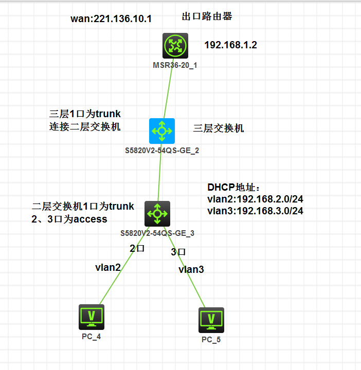

 H3C> <H3C> <H3C> <H3C>system-view System View: return to User View with Ctrl+Z. dhcp enable vlan 5 port GigabitEthernet 1/0/5 quit vlan 6 port GigabitEthernet 1/0/6 quit vlan 7 port GigabitEthernet 1/0/7 quit interface vlan 5 ip address 192.168.6.254 24 quit interface vlan 5 ip address 192.168.5.254 24 quit interface vlan 6 ip address 192.168.6.254 24 quit interface vlan 7 ip address 192.168.7.254 24 quit dhcp server f dhcp server forbidden-ip 192.168.5.100 dhcp server forbidden-ip 192.168.6.100 dhcp server forbidden-ip 192.168.7.100 dhcp server ip-pool 5 network 192.168.5.0 mask 255.255.255.0 dns dns-list 8.8.8.8 gateway-list 192.168.5.254 quit dns-list 8.8.8.8 114.114.114.114 dhcp server ip-pool 5 dns-list 8.8.8.8 114.114.114.114 dhcp server ip-pool 6 network 192.168.6.0 mask 255.255.255.0 dns-list 8.8.8.8 gateway-list 192.168.6.254 quit dhcp server ip-pool 7 [H3C-dhcp-pool-7]network 192.168.7.0 mask 255.255.255.0 [H3C-dhcp-pool-7]dns-list 8.8.8.8 [H3C-dhcp-pool-7] gateway-list 192.168.7.254 [H3C-dhcp-pool-7]quit save force
一、pc端怎么获得的地址是192.168.5.0/16
二、为什么在路由器下不能执行

你配置放行vlan 与你图上贴出来的vlan 以及DHCP根本不相同。你实际配置的vlan 5 6 7
图上是vlan 2 3的配置。麻烦把实际配置配置贴出来吧
zhiliao_nF6ww7 知了小白
没有配置VLAN 5 6呀。就是根据下面配置的了。
[H3C]display current-configuration # version 7.1.075, Alpha 7571 # sysname H3C # irf mac-address persistent timer irf auto-update enable undo irf link-delay irf member 1 priority 1 # dhcp enable dhcp server forbidden-ip 192.168.2.1 dhcp server forbidden-ip 192.168.3.1 # lldp global enable # system-working-mode standard xbar load-single password-recovery enable lpu-type f-series # vlan 1 # vlan 2 to 3 # stp global enable # dhcp server ip-pool vlan2 gateway-list 192.168.2.1 network 192.168.2.0 mask 255.255.255.0 # dhcp server ip-pool vlan3 gateway-list 192.168.3.1 network 192.168.3.0 mask 255.255.255.0 # interface NULL0 # interface Vlan-interface1 ip address 192.168.1.1 255.255.255.0 # interface Vlan-interface2 ip address 192.168.2.1 255.255.255.0 # interface Vlan-interface3 ip address 192.168.3.1 255.255.255.0 # interface FortyGigE1/0/53 port link-mode bridge # interface FortyGigE1/0/54 port link-mode bridge # interface GigabitEthernet1/0/1 port link-mode bridge port link-type trunk port trunk permit vlan 1 to 3 combo enable fiber # interface GigabitEthernet1/0/2 port link-mode bridge port access vlan 2 combo enable fiber # interface GigabitEthernet1/0/3 port link-mode bridge port access vlan 3 combo enable fiber # interface GigabitEthernet1/0/4 port link-mode bridge combo enable fiber # interface GigabitEthernet1/0/5 port link-mode bridge combo enable fiber # interface GigabitEthernet1/0/6 port link-mode bridge combo enable fiber # interface GigabitEthernet1/0/7 port link-mode bridge combo enable fiber # interface GigabitEthernet1/0/8 port link-mode bridge combo enable fiber # interface GigabitEthernet1/0/9 port link-mode bridge combo enable fiber # interface GigabitEthernet1/0/10 port link-mode bridge combo enable fiber # interface GigabitEthernet1/0/11 port link-mode bridge combo enable fiber # interface GigabitEthernet1/0/12 port link-mode bridge combo enable fiber # interface GigabitEthernet1/0/13 port link-mode bridge combo enable fiber # interface GigabitEthernet1/0/14 port link-mode bridge combo enable fiber # interface GigabitEthernet1/0/15 port link-mode bridge combo enable fiber # interface GigabitEthernet1/0/16 port link-mode bridge combo enable fiber # interface GigabitEthernet1/0/17 port link-mode bridge combo enable fiber # interface GigabitEthernet1/0/18 port link-mode bridge combo enable fiber # interface GigabitEthernet1/0/19 port link-mode bridge combo enable fiber # interface GigabitEthernet1/0/20 port link-mode bridge combo enable fiber # interface GigabitEthernet1/0/21 port link-mode bridge combo enable fiber # interface GigabitEthernet1/0/22 port link-mode bridge combo enable fiber # interface GigabitEthernet1/0/23 port link-mode bridge combo enable fiber # interface GigabitEthernet1/0/24 port link-mode bridge combo enable fiber # interface GigabitEthernet1/0/25 port link-mode bridge combo enable fiber # interface GigabitEthernet1/0/26 port link-mode bridge combo enable fiber # interface GigabitEthernet1/0/27 port link-mode bridge combo enable fiber # interface GigabitEthernet1/0/28 port link-mode bridge combo enable fiber # interface GigabitEthernet1/0/29 port link-mode bridge combo enable fiber # interface GigabitEthernet1/0/30 port link-mode bridge combo enable fiber # interface GigabitEthernet1/0/31 port link-mode bridge combo enable fiber # interface GigabitEthernet1/0/32 port link-mode bridge combo enable fiber # interface GigabitEthernet1/0/33 port link-mode bridge combo enable fiber # interface GigabitEthernet1/0/34 port link-mode bridge combo enable fiber # interface GigabitEthernet1/0/35 port link-mode bridge combo enable fiber # interface GigabitEthernet1/0/36 port link-mode bridge combo enable fiber # interface GigabitEthernet1/0/37 port link-mode bridge combo enable fiber # interface GigabitEthernet1/0/38 port link-mode bridge combo enable fiber # interface GigabitEthernet1/0/39 port link-mode bridge combo enable fiber # interface GigabitEthernet1/0/40 port link-mode bridge combo enable fiber # interface GigabitEthernet1/0/41 port link-mode bridge combo enable fiber # interface GigabitEthernet1/0/42 port link-mode bridge combo enable fiber # interface GigabitEthernet1/0/43 port link-mode bridge combo enable fiber # interface GigabitEthernet1/0/44 port link-mode bridge combo enable fiber # interface GigabitEthernet1/0/45 port link-mode bridge combo enable fiber # interface GigabitEthernet1/0/46 port link-mode bridge combo enable fiber # interface GigabitEthernet1/0/47 port link-mode bridge combo enable fiber # interface GigabitEthernet1/0/48 port link-mode bridge combo enable fiber # interface M-GigabitEthernet0/0/0 # interface Ten-GigabitEthernet1/0/49 port link-mode bridge combo enable fiber # interface Ten-GigabitEthernet1/0/50 port link-mode bridge combo enable fiber # interface Ten-GigabitEthernet1/0/51 port link-mode bridge combo enable fiber # interface Ten-GigabitEthernet1/0/52 port link-mode bridge combo enable fiber # scheduler logfile size 16 # line class aux user-role network-operator # line class console user-role network-admin # line class tty user-role network-operator # line class vty user-role network-operator # line aux 0 user-role network-operator # line con 0 user-role network-admin # line vty 0 63 user-role network-operator # ip route-static 0.0.0.0 0 192.168.1.2 # radius scheme system user-name-format without-domain # domain name system # domain default enable system # role name level-0 description Predefined level-0 role # role name level-1 description Predefined level-1 role # role name level-2 description Predefined level-2 role # role name level-3 description Predefined level-3 role # role name level-4 description Predefined level-4 role # role name level-5 description Predefined level-5 role # role name level-6 description Predefined level-6 role # role name level-7 description Predefined level-7 role # role name level-8 description Predefined level-8 role # role name level-9 description Predefined level-9 role # role name level-10 description Predefined level-10 role # role name level-11 description Predefined level-11 role # role name level-12 description Predefined level-12 role # role name level-13 description Predefined level-13 role # role name level-14 description Predefined level-14 role # user-group system # return
