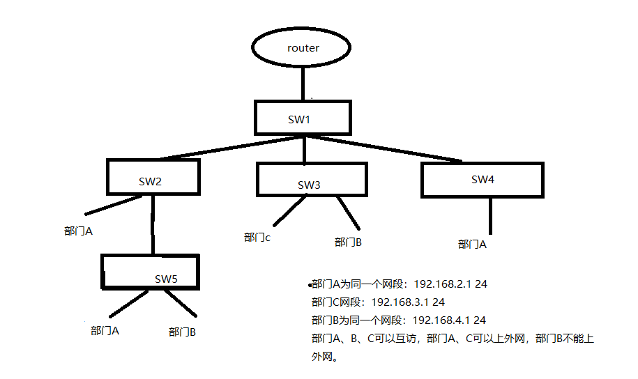

组网及VLAN设置
2020-06-01提问
  • 1收藏,3017浏览
1、组网要求如上图,路由器是MSR3610,交换机是S5000系列,求路由器交换机配置具体命令。
2、SW2是不是也作为二层交换机?

需求不明确,请确认网关位置
网关在SW1上

1、根据您的概述,建议网关都放置在SW1上,以下是SW1配置要点:
vlan 10
vlan 20
vlan 30
int vlan 10
ip address 192.168.2.1 24
int vlan 20
ip address 192.168.3.1 24
int vlan 30
ip address 192.168.4.1 24
2、SW2、SW3、SW4、SW5可以作为二层交换机,同时与SW1使用trunk互联。
SW1配置如下:
int range gi 1/0/1 to gi 1/0/3
port link-type trunk
undo port trunk permit vlan 1
port trunk permit vlan 10 20 30
SW2配置如下:
vlan 10
vlan 30
int gi 1/0/1 (与SW1互联)
port trunk permit vlan 10 30
int gi 1/0/2 (与部门A互联)
port link-type access
port access vlan 10
int gi 1/0/3(与SW5互联)
port trunk permit vlan 30
SW5配置:
vlan 30
int gi 1/0/1(与SW2互联)
int gi 1/0/2 (与部门B互联)
port access vlan 30
SW3:
vlan 20
vlan 30
port trunk permit vlan 20 30
int gi 1/0/2 (与部门C互联)
port access vlan 20
int gi 1/0/3 (与部门B互联)
port access vlan 30
SW4:
vlan 10
port access vlan 10
3、建议SW1与路由器走三层路由转发,具体配置如下:
SW1:
int gi 1/0/24
port link-mode route
ip address 10.0.0.1 30
ospf 1 router-id 10.0.0.1
area 0.0.0.0
network 10.0.0.1 0.0.0.0
network 192.168.2.0 0.0.0.255
network 192.168.3.0 0.0.0.255
network 192.168.4.0 0.0.0.255
路由器:
int gi 0/0
ip address 10.0.0.2 30
ospf 1 router-id 10.0.0.2
area 0.0.0.0
network 10.0.0.2 0.0.0.0
4、要实现部门B不能访问外网,在路由器的出口做限制即可。
acl basic 2000
rule 0 deny source 192.168.3.0 0.0.0.255
rule 1 permit source any
int gi 0/1
ip address 202.1.100.2 30
nat outbound 2000
ip route-static 0.0.0.0 0.0.0.0 202.1.100.1
ospf 1
import-route static
import-route direct
以上是配置过程,仅供参考,具体以实际的IP规划为准,请悉知!
