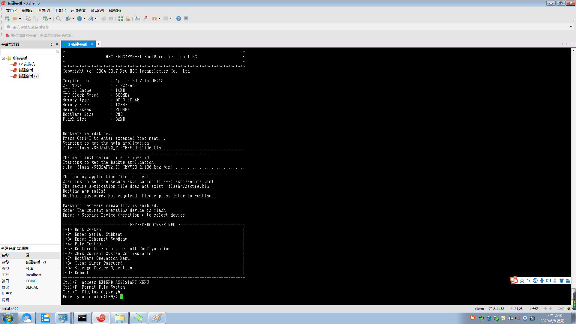

交换机开机一直自动进EXTEND-BOOTWARE MENU

设置列表 有序列表 无序列表 型号:S5024PV2-EI交换机开机一直自动进BOOTWARE菜单

没有版本文件吧,或者版本文件损坏了,重新下载一个新的版本文件在bootware界面中导入一下启动。

===============================<File CONTROL>===============================
 |Note:the operating device is flash |
 |<1> Display All File(s) |
|<2> Set Application File type |
|<3> Set Configuration File type |
 |<4> Delete File  |
 |<0> Exit To Main Menu |
 Enter your choice(0-4): 1 Display all file(s) in flash:
 "M" = MAIN "B" = BACKUP "S" = SECURE "N/A" = NOT ASSIGNED
 |NO. Size(B) Time Type Name |
|1 12519424 Aug/08/2008 20:00:00 M s5024pv2_ei-cmw520-r1106.bin |
 |2 12519424 Aug/08/2008 20:00:00 B s5024pv2_ei-cmw520-r1106_b~001 |
 |3 1048527 Aug/14/2000 01:31:42 N/A logfile/logfile.log |
粉丝:0人 关注:2人
版本文件损坏或丢失,重新长传一下吧。
http://www.h3c.com/cn/d_201904/1161895_30005_40.htm
先输入3 ,然后选 Modify Ethernet Parameter 设置完FTP参数以后,再选2

菜单输入3 然后2吗

1、可能是系统文件损坏或丢失,先按4看下是否有系统文件。

Display all file(s) in flash: 'M' = MAIN 'B' = BACKUP 'S' = SECURE 'N/A' = NOT ASSIGNED ============================================================================ |NO. Size(B) Time Type Name | |1 12519424 Aug/08/2008 20:00:00 M s5024pv2_ei-cmw520-r1106.bin | |2 12519424 Aug/08/2008 20:00:00 B s5024pv2_ei-cmw520-r1106_b~001 | |3 1048527 Aug/14/2000 01:31:42 N/A logfile/logfile.log | ============================================================================

您好,看到有系统文件,可尝试引导看下是否能启动
得闲饮茶013 发表时间:2020-06-08
你好 怎么引导启动呢 你看下我前面发的图片
影 发表时间:2020-06-08
您好,选1,boot system看下。
Enter your choice(0-9): 1 Starting to get the main application file--flash:/S5024PV2_EI-CMW520-R1106.bin!.................................. ............................................................. The main application file is invalid! Starting to get the backup application file--flash:/S5024PV2_EI-CMW520-R1106_bak.bin!.............................. .................................................................. The backup application file is invalid! Starting to get the secure application file--flash:/secure.bin! The secure application file does not exist--flash:/secure.bin! Booting App fails!

不可用,可能文件损坏了,重新导入一个试试看吧
