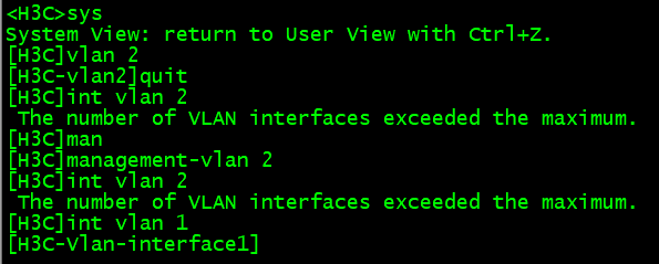

各位前辈好,我这台设备建立新VLAN不能设置ip,只能VLAN1设置,请教大家!谢谢!有点乱,见谅H3C]dis cu version 5.20, Release 5213P08 sysname H3C domain default enable system telnet server enable management-vlan 100 password-recovery enable vlan 1 vlan 100 domain system access-limit disable state active idle-cut disable self-service-url disable user-group system group-attribute allow-guest interface NULL0 interface Vlan-interface1 ip address dhcp-alloc client-identifier mac Vlan-interface1 interface Ethernet1/0/1 interface Ethernet1/0/2 interface Ethernet1/0/3 interface Ethernet1/0/4 interface Ethernet1/0/5 interface Ethernet1/0/6 interface Ethernet1/0/7 interface Ethernet1/0/8 interface Ethernet1/0/9 interface Ethernet1/0/10 interface Ethernet1/0/11 interface Ethernet1/0/12 interface Ethernet1/0/13 interface Ethernet1/0/14 interface Ethernet1/0/15 interface Ethernet1/0/16 interface Ethernet1/0/17 interface Ethernet1/0/18 interface Ethernet1/0/19 interface Ethernet1/0/20 interface Ethernet1/0/21 interface Ethernet1/0/22 interface Ethernet1/0/23 interface Ethernet1/0/24 interface GigabitEthernet1/0/25 interface GigabitEthernet1/0/26 load xml-configuration load tr069-configuration user-interface aux 0 user-interface vty 0 15 return [H3C]int vlan 100  The number of VLAN interfaces exceeded the maximum. [H3C]int vlan 1 [H3C-Vlan-interface1]quit [H3C]

该设备只支持创建一个vlan接口
S3100V2系列交换机支持创建一个VLAN接口。
可以先undo int vlan 1,然后再创建其他vlan的接口看一下
您太厉害了,问题已解决,谢谢

具体是什么型号的设备?

正常的话不应该啊,我有一模一样的设备,一模一样的固件,就没问题

S3100-26TP-SI

vlan 2 int vlan 2 ip add 1.1.1.1 32 配置上述命令试试 这个设备应该是可以创建IP地址的

[H3C]int vlan 2 The number of VLAN interfaces exceeded the maximum. [H3C]

报错的意思就是说只能新建一个vlan-if了

如图
可尝试进入Int vlan 1后shutdown。然后再undo int vlan 1.最后再进入int vlan 2设置IP地址看看是否可行。
