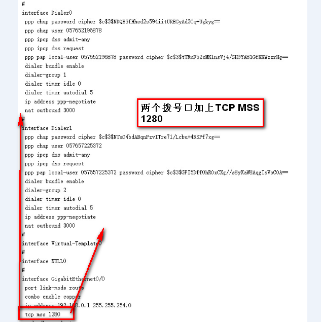

1、将外网拨号口的的tcp mss值统一设置为1280
2、将交换机的生成树关闭一下测试。

# version 7.1.064, Release 0605P13 # sysname H3C # clock timezone Beijing add 08:00:00 clock protocol ntp # dialer-group 1 rule ip permit dialer-group 2 rule ip permit # dhcp enable dhcp server always-broadcast # dns proxy enable # password-recovery enable # vlan 1 # dhcp server ip-pool 10 gateway-list 192.168.2.1 network 192.168.2.0 mask 255.255.255.0 dns-list 60.191.134.196 expired day 7 # dhcp server ip-pool 20 gateway-list 192.168.3.1 network 192.168.3.0 mask 255.255.255.0 dns-list 60.191.134.196 expired day 7 # dhcp server ip-pool 30 gateway-list 192.168.4.1 network 192.168.4.0 mask 255.255.255.0 dns-list 60.191.134.196 expired day 7 # dhcp server ip-pool lan1 gateway-list 192.168.0.1 network 192.168.0.0 mask 255.255.254.0 address range 192.168.1.2 192.168.1.254 dns-list 192.168.0.1 # controller Cellular0/0 # controller Cellular0/1 # interface Aux0 # interface Dialer0 ppp chap password cipher $c$3$NDQBSfHhed2s594iitUREGyAd3Cq+Ugkyg== ppp chap user 057652196878 ppp ipcp dns admit-any ppp ipcp dns request ppp pap local-user 057652196878 password cipher $c$3$tTRuF52xMKlnsVj4/SH9YA81GfKKWzzrHg== dialer bundle enable dialer-group 1 dialer timer idle 0 dialer timer autodial 5 ip address ppp-negotiate tcp mss 1280 nat outbound 3000 # interface Dialer1 ppp chap password cipher $c$3$NTaO4bdABqnPzvITre71/Lcbu+4RSPf7xg== ppp chap user 057657225372 ppp ipcp dns admit-any ppp ipcp dns request ppp pap local-user 057657225372 password cipher $c$3$GPI5Dff0hROxCXg//s8yXaW8AqgIsVoCOA== dialer bundle enable dialer-group 2 dialer timer idle 0 dialer timer autodial 5 ip address ppp-negotiate tcp mss 1280 nat outbound 3000 # interface Virtual-Template0 # interface NULL0 # interface GigabitEthernet0/0 port link-mode route combo enable copper ip address 192.168.0.1 255.255.254.0 tcp mss 1280 undo dhcp select server # interface GigabitEthernet0/0.10 ip address 192.168.2.1 255.255.255.0 vlan-type dot1q vid 10 # interface GigabitEthernet0/0.20 ip address 192.168.3.1 255.255.255.0 vlan-type dot1q vid 20 # interface GigabitEthernet0/0.30 ip address 192.168.4.1 255.255.255.0 vlan-type dot1q vid 30 # interface GigabitEthernet0/1 port link-mode route description Multiple_Line pppoe-client dial-bundle-number 0 # interface GigabitEthernet0/2 port link-mode route description Multiple_Line pppoe-client dial-bundle-number 1 # security-zone name Local # security-zone name Trust # security-zone name DMZ # security-zone name Untrust # security-zone name Management # scheduler logfile size 16 # line class aux user-role network-admin # line class tty user-role network-operator # line class vty user-role network-operator # line aux 0 user-role network-admin # line vty 0 63 authentication-mode scheme user-role network-operator # ip route-static 0.0.0.0 0 Dialer0 ip route-static 0.0.0.0 0 Dialer1 # ntp-service enable # acl advanced 3000 rule 100 deny ip source 192.168.4.0 0.0.0.255 rule 200 permit ip # domain system # domain default enable system # role name level-0 description Predefined level-0 role # role name level-1 description Predefined level-1 role # role name level-2 description Predefined level-2 role # role name level-3 description Predefined level-3 role # role name level-4 description Predefined level-4 role # role name level-5 description Predefined level-5 role # role name level-6 description Predefined level-6 role # role name level-7 description Predefined level-7 role # role name level-8 description Predefined level-8 role # role name level-9 description Predefined level-9 role # role name level-10 description Predefined level-10 role # role name level-11 description Predefined level-11 role # role name level-12 description Predefined level-12 role # role name level-13 description Predefined level-13 role # role name level-14 description Predefined level-14 role # user-group system # local-user admin class manage password hash $h$6$we9tKLJbkCnTWNQB$jv2z96DGrtbqx3AKwuHTNtggbAA/RmELvr8qXqv4hv0AzuNq5b3JIw/Bh7of0OBSwbuGRu0qk+bd0ibiIiByFA== service-type telnet http authorization-attribute user-role network-admin # ip http enable # wlan global-configuration control-address disable # wlan ap-group default-group # return

大神,帮我看下路由器上这个配置,那些要优化,那些要删除的
zhiliao_eE4At4 发表时间:2020-06-22
配置是乱的,直接说问题吧
知了知了 发表时间:2020-06-22
我直接再提问把,您帮我看下哪些命令行要删除,哪些要改
