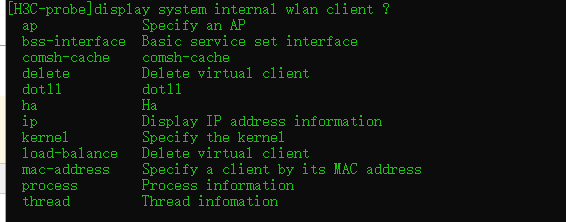

[H3C-probe]display system internal wlan client ? ap Specify an AP bss-interface Basic service set interface comsh-cache comsh-cache delete Delete virtual client dot11 dot11 ha Ha ip Display IP address information kernel Specify the kernel load-balance Delete virtual client mac-address Specify a client by its MAC address process Process information thread Thread infomation 没有您说的命令行

没有您所说的这个命令,命令行截图如下
