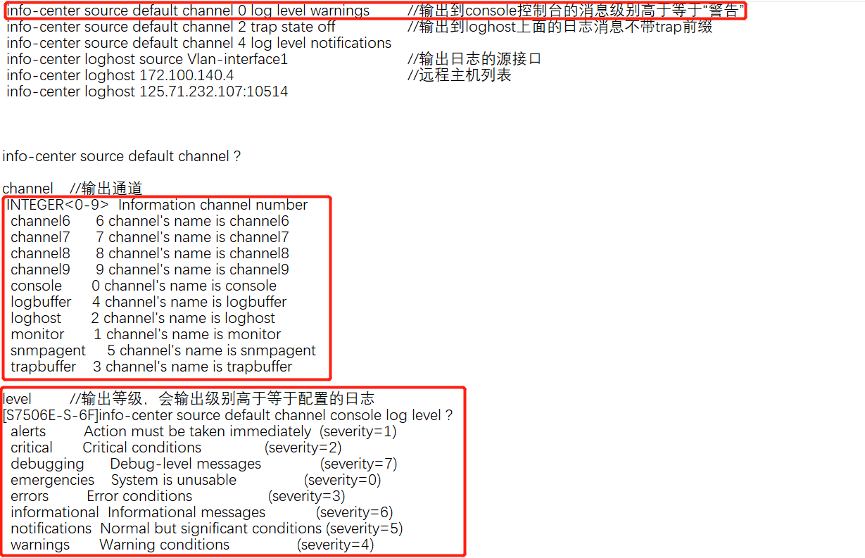

用什么命令可以调整一下日志输出的级别,现在查看日志全部被流量匹配日志给打满了,只想保留操作日志和告警日志
粉丝:18人 关注:0人
可以把不想看到的模块deny掉
[FW]info-center source xxxx logbuffer/logfile ?
    deny Deny to output logs with any severity level
    level Set the severity level above which the system suppresses logs to the specified                module. Setting the level to errors, for example, allows logs with levels
            emergencies, alerts, critical and errors to display
粉丝:11人 关注:2人
[H3C]info-center source default channel 0 log level warnings
