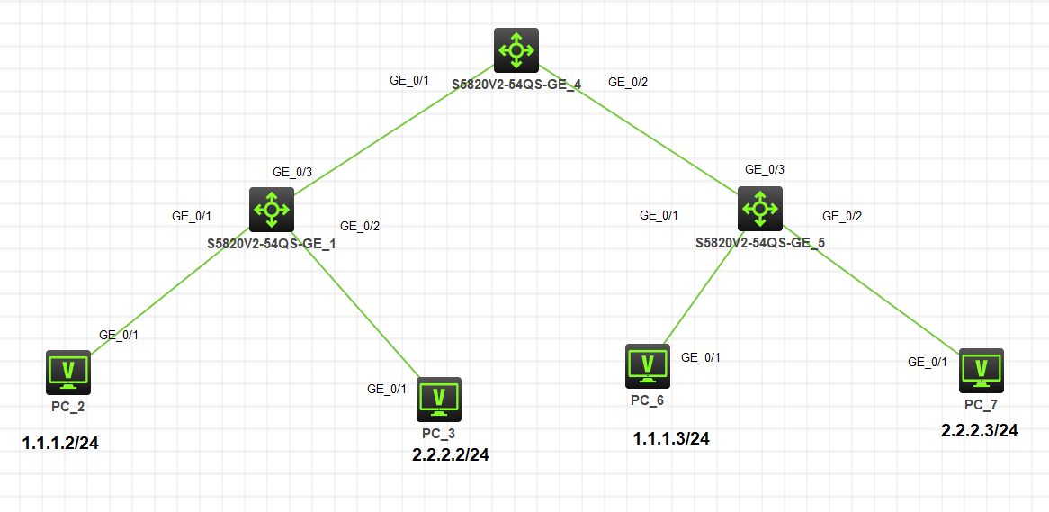

设置列表 有序列表 无序列表对齐方式 靠左 居中 靠右 # vlan 10 ip-subnet-vlan 0 ip 1.1.1.0 255.255.255.0 # vlan 20  ip-subnet-vlan 0 ip 2.2.2.0 255.255.255.0  # interface Vlan-interface10  ip address 1.1.1.1 255.255.255.0 # interface Vlan-interface20  ip address 2.2.2.1 255.255.255.0# interface GigabitEthernet1/0/1  port link-mode bridge  port link-type hybrid  port hybrid vlan 1 10 20 untagged  port hybrid ip-subnet-vlan vlan 10  port hybrid ip-subnet-vlan vlan 20  combo enable fiber # interface GigabitEthernet1/0/2  port link-mode bridge  port link-type hybrid  port hybrid vlan 1 10 20 untagged  port hybrid ip-subnet-vlan vlan 10  port hybrid ip-subnet-vlan vlan 20  combo enable fiber配置如上、网络结构看下图。我想的是核心交换机的G1/0/1口可以通行VLAN 10 /20的数据包。但是1.1.1.2无法ping通任何地址,1.1.1.1,1.1.1.3,2.2.2.1,2.2.2.2,2.2.2.3.请问怎么回事?谢谢。
