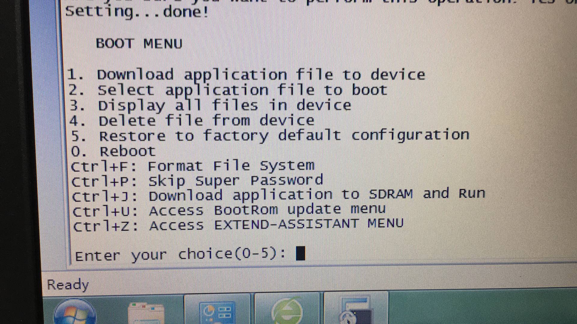

如题,机器配置需要保存,console密码忘记怎么恢复?ctrl+B 进入的Boot Menu 界面如下

导出配置方法如下,启动按Ctrl+B进入Bootware菜单
BOOT MENU
1. Download application file to device
2. Select application file to boot
3. Display all files in device
4. Delete file from device
5. Modify bootrom password
0. Reboot
Enter your choice(0-5): 3 //先显示一下设备中间的文件
Flash:/
File Number File Size(bytes) File Name
0(*). 31453692 s7500e-cmw520-r6605.app
1. 1000 private-data.txt
2. 4 snmpboots
3. 19721694 s7500e-cmw520-f6306l03.app
4. 716 hostkey
5. 572 serverkey
6. 12566 patchmain
7. 16332 patchio
8. 490 patchstate
9. 864024 io_mon.txt
10. 299 ss
11. 1761681 default.diag
12. 151 system.xml
Flash Free Space : 11808 KB
The current application file is: flash:/s7500e-cmw520-r6605.app
The backup application file is: flash:/s7500e-cmw520-r6305p03.app
BOOT MENU
0. Reboot
Enter your choice(0-5): //按一下Ctrl+Y
Please select application file upload choices:
1. Upload file from Flash via TFTP protocol
2. Upload file from CF card via TFTP protocol
0. Return to boot menu
Enter your choice(0-2): 1 //选择1
Please set TFTP protocol parameters:
Load File name :mpu207.app private-data.txt //输入要下载的文件名
Switch IP address :192.168.8.2 192.168.1.2 //交换机的IP
Server IP address :192.168.8.6 192.168.1.1 //TFTP Server的IP
Are you sure you want to upload file from flash? Yes or No(Y/N) y
Attached TCP/IP interface to fei1.
Attaching network interface lo0... done.
Prepare for transmitting....................................OK!
Uploading...........done!
看图片 没有Ctrl+Y 的提示呀

看图片 没有Ctrl+Y 的提示呀
zhiliao_XCXGOd 发表时间:5小时前
在启动过程中ctrl+b进入扩展段,先选择跳过当前配置选项,然后选择reboot,进入命令行之后通过tftp/ftp导出配置文件.cfg 。然后修改配置文件,取消console口密码或者修改密码再重新导入设备即可。
