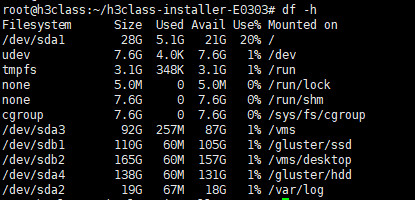

cas是E0509的版本,已经安装过2次,步骤没有错误
分区挂载情况

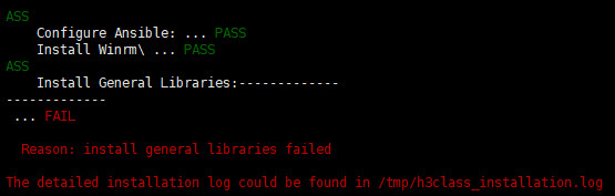

把日志中的报错贴出来看看
Install General Libraries:Reading package lists... Building dependency tree... Reading state information... You might want to run 'apt-get -f install' to correct these: The following packages have unmet dependencies: python-sqlalchemy-ext : Depends: python-sqlalchemy (= 0.7.4-1ubuntu0.1) but 0.7.4-1 is to be installed E: Unmet dependencies. Try 'apt-get -f install' with no packages (or specify a solution). FAIL (B  Reason: install general libraries failed
笃行之 发表时间:2018-04-10 更多>>
