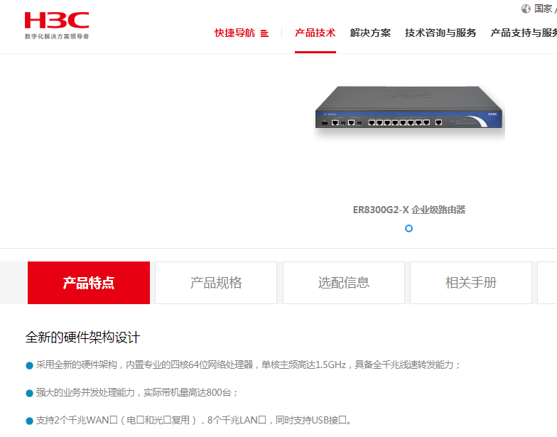

ER8300G2-X的规格信息如下:
https://www.h3c.com/cn/Products___Technology/Products/Router/Catalog/ER_G2/ER8300G2-X/
但是官网的ER8300G2-X的带机量有800台,所以路由器是满足基本条件了:
