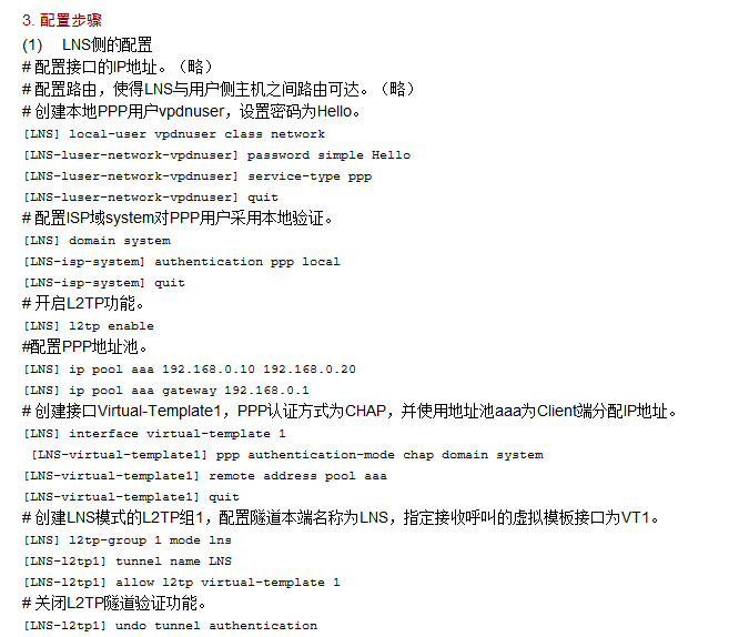

FW1 L2TP VPN LNS关键配置点:
[FW1]local-user weijianing class network
New local user added.
[FW1-luser-network-weijianing]password simple weijianing
[FW1-luser-network-weijianing]service-type ppp
[FW1-luser-network-weijianing]quit
[FW1]domain system
[FW1-isp-system]authentication ppp local
[FW1-isp-system]quit
[FW1]ip pool weijianing 172.16.1.2 172.16.1.254
[FW1]ip pool weijianing gateway 172.16.1.1
[FW1]int Virtual-Template 1
[FW1-Virtual-Template1]ip address 172.16.1.1 24
[FW1-Virtual-Template1]ppp authentication-mode chap domain system
[FW1-Virtual-Template1]remote address pool weijianing
[FW1-Virtual-Template1]quit
[FW1]security-zone name Untrust
[FW1-security-zone-Untrust]import interface Virtual-Template 1
[FW1-security-zone-Untrust]quit
[FW1]l2tp enable
[FW1]l2tp-group 1 mode lns
[FW1-l2tp1]undo tunnel authentication
[FW1-l2tp1]tunnel name LNS
[FW1-l2tp1]allow l2tp virtual-template 1
[FW1-l2tp1]quit

3.5  建立VPN拨号账户
#创建本地PPP用户vpdnuser,设置密码为HelLo。
[H3C]Local-user vpdnuser class network
[H3C-luser-network-vpdnuser]password simple HelLo
[H3C-luser-network-vpdnuser]service-type ppp
[H3C-luser-network-vpdnuser]quit
3.6  开启L2TP功能
[H3C]l2tp enable
3.7  配置L2TP用户地址池
#创建用于给L2TP拨号用户分配地址的地址池。
[H3C] ip pool aaa 192.168.100.2 192.168.100.254
[H3C] ip pool aaa gateway 192.168.100.1
3.8  创建L2TP接口
#创建接口Virtual-Template1,PPP认证方式为CHAP,并使用地址池aaa为Client端分配IP地址。
[H3C]interface virtual-template 1
[H3C -Virtual-Template1]ppp authentication-mode chap domain system
[H3C -Virtual-Template1]ip address 192.168.100.1 24
[H3C-Virtual-Template1]remote address pool aaa
[H3C-Virtual-Template1]quit
3.9  创建L2TP组1
# 创建LNS模式的L2TP组1,配置隧道本端名称为LNS,指定接收呼叫的虚拟模板接口为VT1。
[H3C]l2tp-group 1 mode lns
[H3C-l2tp1]tunnel name LNS
[H3C-l2tp1]allow l2tp virtual-template 1
[H3C-l2tp1]undo tunnel authentication
[H3C-l2tp1]quit
