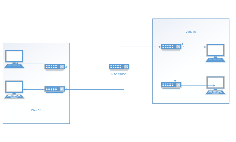

H3C S5800设备上建了两个虚接口
vlanif 10(172.17.41.1 255.255.255.0)   vlanif 20(17217.40.1 255.255.255.0)
S5800和接入交换机之间建立了trunk链路,接入交换机端口也已经设置了vlan access
按道理来说 172.17.41.0和172.17.40.0两个网段之间应该是可以互通的,但是现在为啥不通啊
请问有什么办法可以排除下问题所在吗?

你好,就是按照你说的操作的,S5800建立 vlan10 20 属于vlan10 的交换机建了 vlan10 属于vlan20 的交换机建立vlan20 S5800与接入交换机之间设置的是vlan all 接入交换机上也设置了vlan access 还是不通 还有别的解决办法吗?

S5800 配置 (21-24口是连接vlan10区域4台接入交换机 25-28口是连接vlan20区域四台接入交换机 25-28是通过光纤连接的) vlan 10 description to-user # vlan 20 description to-user-D5 interface GigabitEthernet1/0/21 port link-mode bridge port link-type trunk port trunk permit vlan all # interface GigabitEthernet1/0/22 port link-mode bridge port link-type trunk port trunk permit vlan all # interface GigabitEthernet1/0/23 port link-mode bridge port link-type trunk port trunk permit vlan all # interface GigabitEthernet1/0/24 port link-mode bridge port link-type trunk port trunk permit vlan all interface Ten-GigabitEthernet1/0/25 port link-mode bridge port link-type trunk port trunk permit vlan all # interface Ten-GigabitEthernet1/0/26 port link-mode bridge port link-type trunk port trunk permit vlan all # interface Ten-GigabitEthernet1/0/27 port link-mode bridge port link-type trunk port trunk permit vlan all # interface Ten-GigabitEthernet1/0/28 port link-mode bridge port link-type trunk port trunk permit vlan all 各接入交换机配置大概和如下差不多 vlan 10 description to-user&manage # interface Vlan-interface10 ip address 172.17.41.201 255.255.255.0 # interface Aux1/0/0 # interface Ethernet1/0/1 port access vlan 10 # interface Ethernet1/0/2 port access vlan 10 # interface Ethernet1/0/3 port access vlan 10 # interface Ethernet1/0/4 port access vlan 10

172.17.41.112 255.255.255.0 172.17.41.1 172.17.40.112 255.255.255.0 172.17.40.1

interface Vlan-interface10 description to-user ip address 172.17.41.1 255.255.255.0 # interface Vlan-interface20 description to-user-D5 ip address 172.17.40.1 255.255.255.0 有的

看到接入交换机也给vlan 10和vlan 20配置了IP,删除掉了再配置看下。

首先两侧终端ping网关是否通的,如果通的话,理论应该能通;看看是不是终端侧防火墙没关,或者PC有线网走了无线网络,关闭无线网络看看
