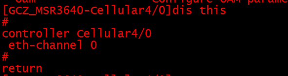

以太网子接口端口无法起来
是4G模块插入路由器需要做什么措施吗

[GCZ_MSR3640]dis cellular 4/0 Cellular4/0: Modem State: Hardware Information: Model: U8300C Manufacturer: LONGSUNG Modem Firmware Version: QA30002.1.6_MV11(4534_1.2.3_L0801) International Mobile Equipment Identity (IMEI): 869751028263729 International Mobile Subscriber Identity (IMSI): 460013169610081 Mobile Equipment Identifier (MEID): A100005B1C5093 Hardware Version: 30000 Modem Status: Online Modem Status: IPv4 Unkown. Modem Status: IPv6 Unkown. Profile Information: Profile index: 1 PDP Type: IPv4v6 Header Compression: Off Data Compression: Off Access Point Name (APN): GSQXJBW.GS Authentication: CHAP Username: card * - Default profile Network Information: Current Service Status: Service Available Registration Status: Registered Current Service: Combined Current Roaming Status: Home Current Data Bearer Technology: Unknown Network Selection Mode: Automatic Current IP address Mode: IPv4 Cellular-alloc Mobile Country Code (MCC): 460 Mobile Network Code (MNC): 01 Location Area Code (LAC): 48518 Cell ID: 209614359 Radio Information: Technology Preference: UMTS only Technology Selected: UMTS Configured LTE Band = 1,3,38,39,40,41 WCDMA related info: Current RSSI: -84 dBm Current ECIO: -3 dBm Modem Security Information: PIN Verification: Disabled PIN Status: PIN Requirement Disabled Number of PIN Retries Remaining: 3 Number of PUK Retries Remaining: 10 SIM Status: OK ICCID: 89860113887005270959 MSISDN: +8618693162824 Error Information: IPv4 dialing failed: N/A IPv6 dialing failed: N/A GPS Information: GPS Info: GPS State: Enabled GPS Mode Configured: Standalone Latitude: 29 Deg 59 Min 59 Sec North Longitude: 103 Deg 59 Min 236 Sec East Timestamp (UTC): 00/00/0000 00:00:00 Local time: 00/00/0000 00:00:00 Heading: 0.00, Velocity Horiz: 0.00, Velocity Vert: 0.00 Height (MSL): 31.00 m Satellite Info:
