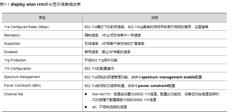

无线优化关闭低速率
radio 1
channel 40
rate mandatory 12 24
rate multicast auto
rate supported 18 36 48 54
rate disabled 6 9
beacon-interval 150
radio enable
radio 2
channel 1
rate mandatory 11
rate multicast auto
rate supported 12 18 24 36 48 54
rate disabled 1 2 5.5 6 9
beacon-interval 150
radio enable
