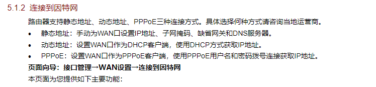

参考一下ER5200G的用户配置手册:https://www.h3c.com/cn/d_201909/1223355_30005_0.htm#_Toc13662314
