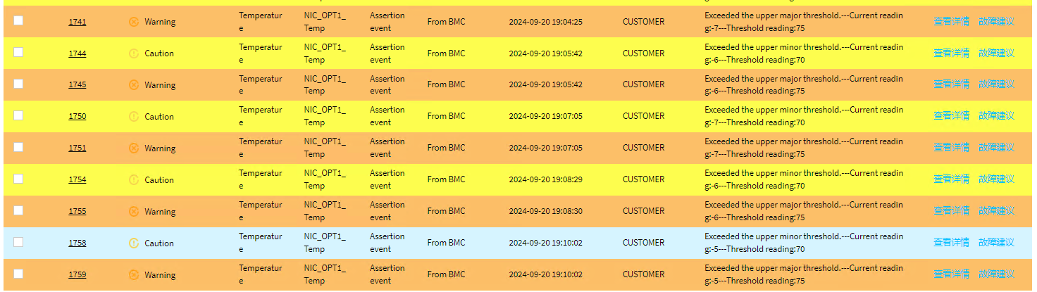

告警信息
 Warning Temperature NIC_OPT1_Temp Assertion event From BMC 2024-09-20 18:20:22 CUSTOMER Exceeded the upper major threshold.---Current reading:-7---Threshold reading:75
 Caution Temperature NIC_OPT1_Temp Assertion event From BMC 2024-09-20 18:21:39 CUSTOMER Exceeded the upper minor threshold.---Current reading:-5---Threshold reading:70
 Warning Temperature NIC_OPT1_Temp Assertion event From BMC 2024-09-20 18:21:40 CUSTOMER Exceeded the upper major threshold.---Current reading:-5---Threshold reading:75

带外网卡报超温,之前更换过网卡,拔掉网卡后故障消失,拔掉网卡光模块问题消失,交换Slot位置,问题依旧

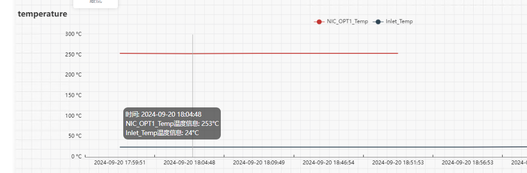

故障现象看,网卡在报超温的过程是设备启动后立刻就会报超温,且日志中看超温度数显示负值,超温告警信息读取到的值也不稳定,实际阈值在70~75℃,网卡NIC_OPT1_Temp温度信息显示253℃,因此判断此告警信息为误告警,查询当前HDM版本较低,建议客户升级HDM到3.49版本
