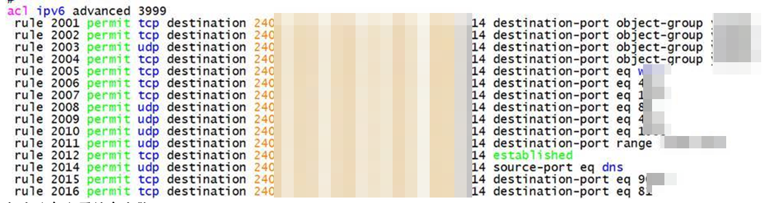

1、正常这样配置可以配进去:

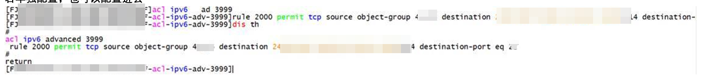

2、加上这条之后就会告警,也未写明acl不支持(rule 2000 permit tcp source object-group xx destination xxxx destination-port eq xx):
%Jan 26 13:28:28:026 2024 xxx PFILTER/3/PFILTER_IF_UNK_ERR: -Slot=3; Failed to apply or refresh IPv6 ACL xxxx rule xxxx to the inbound direction of interface xx.
%Jan 26 13:28:28:132 2024 xxx PFILTER/3/PFILTER_IF_UNK_ERR: -Slot=2; Failed to apply or refresh IPv6 ACL xxxx rule xxxx to the inbound direction of interface xx.
%Jan 26 13:28:28:134 2024 xxx PFILTER/3/PFILTER_IF_UNK_ERR: -Slot=2; Failed to apply or refresh IPv6 ACL xxxx rule xxxx to the inbound direction of interface xx.

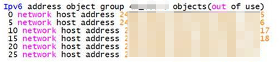

3、对象组信息,若单独配置,也可以配置进去:
4、在acl 3999 ru2000 的CMCC对象组里面是空的,可以成功调用,但是在对象组里加地址后也会报错,也怀疑是ipv6的地址问题。
