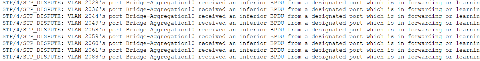

在接入交换机下的终端出现ping网关丢包的情况,测试发生丢包时,接入交换机上联口有stp dispute日志告警
  • 0收藏 201浏览
告警信息
%Sep  3 18:44:39:580 2026 SW_N1-F5-A-N_11.185 STP/4/STP_DISPUTE: VLAN 2028's port Bridge-Aggregation10 received an inferior BPDU from a designated port which is in forwarding or learning state.
