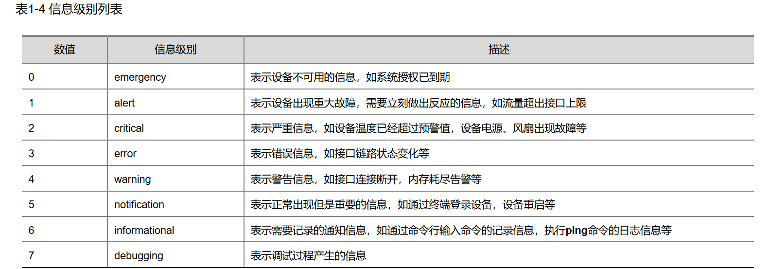

1.截取客户的日志记录,观察日志属于哪一类的信息 display logbuffer
2.屏蔽日志信息 info-center logging suppress module DRVPLAT mnemonic DrvDebug
info-center logging suppress module shell mnemonic shell_cmd_executesuccess
3.属于第六类信息,屏蔽日志:info-center logging suppress module shell mnemonic shell_cmd_executesuccess
